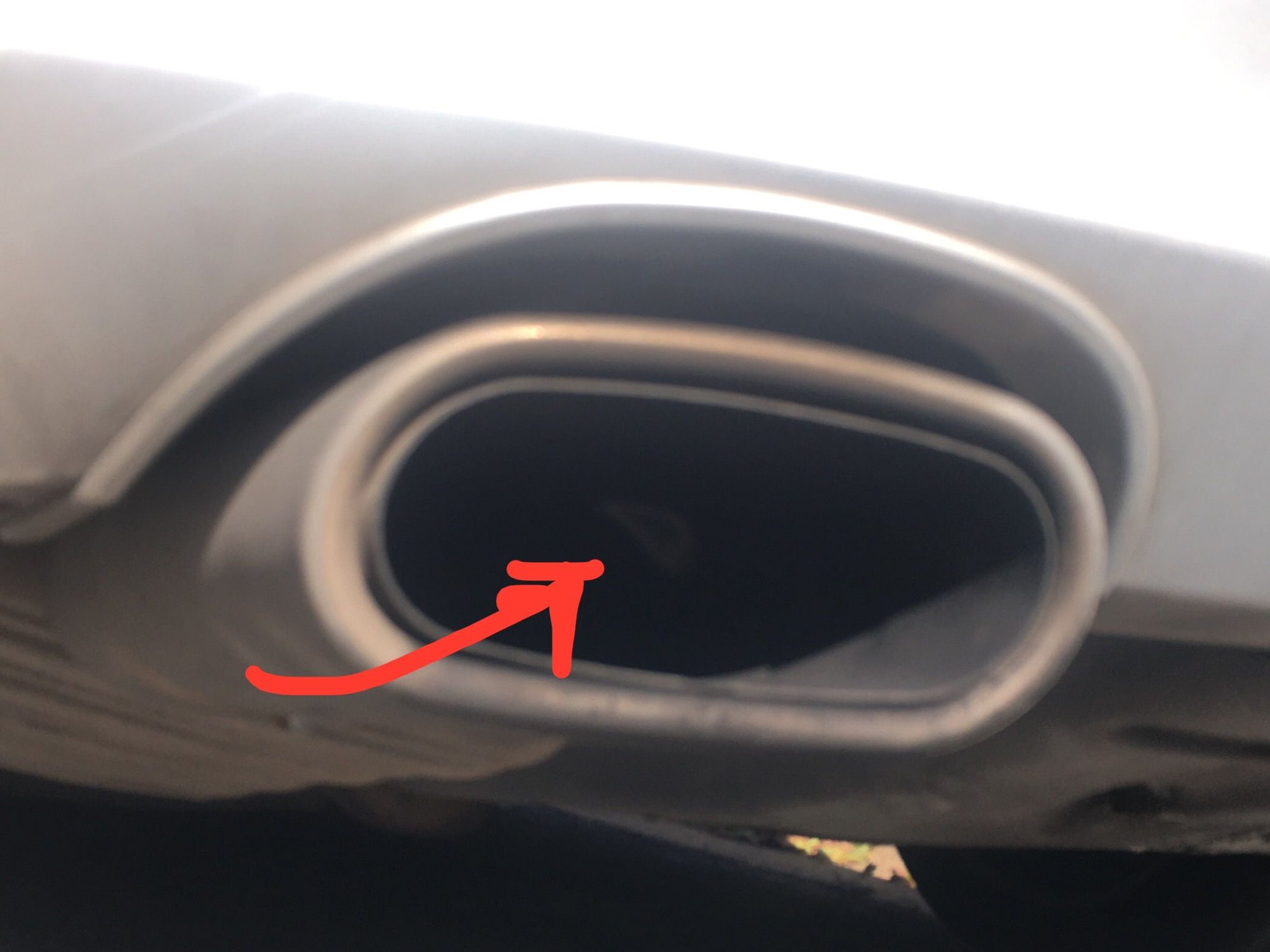

After months of chasing an annoying rattle that occurs when RPM drops from 1200 to 800 has been fixed. I’ve been to numerous muffler shops, indys and even the stealership and was told everything from the timing chain was loose to the cats needed to be replaced to I’d just need to live with it.

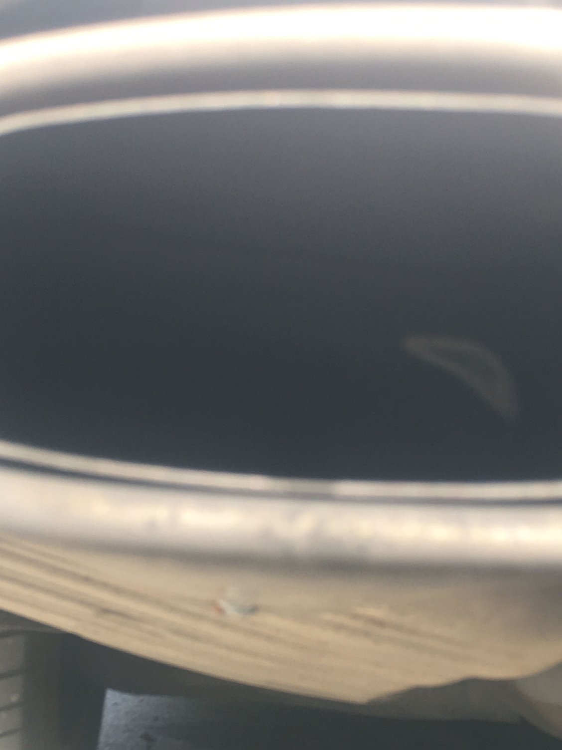

Found a random shop offering just off a gut feeling driving by and the tech was invested in actually chasing the noise. After a few minutes with iron the lift and revving, we found it!
It ended up being the drivers side exhaust tip. One spot weld and rattle is absolutely gone!!
See photos of exact location of welding spot.

Nope! Surprisingly enough the stealership didn’t quote me for the timing chain it was an indy ( their reviews were crap which I should’ve checked out first). The stealership said “just live with it” as, according to them, “there were no visible signs or diagnostic codes…”
