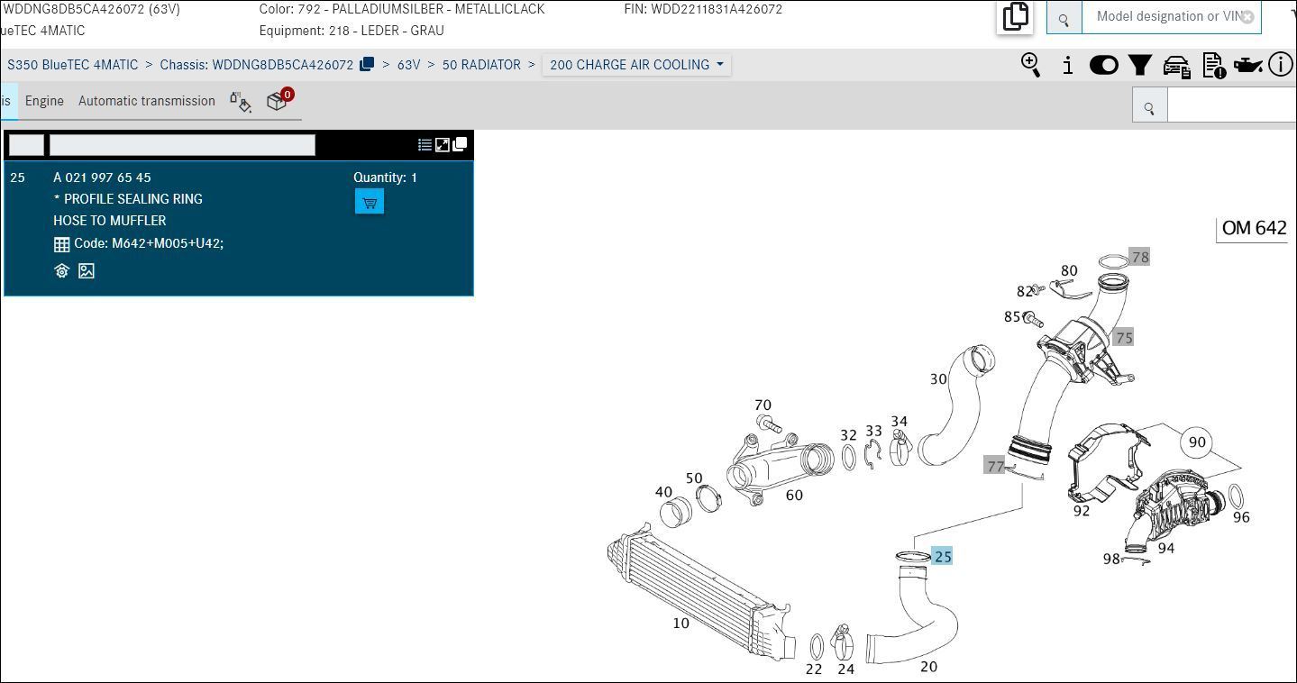

2012 S350 Bluetec. I'm looking for the front pipe (left side of the vehicle) seal. The pipe is very expensive and only the seal is broken. Can't find it anywhere as a separate part. I stumbled across this diagram where it is actually shown as a standalone part (number 25 on the diagram).
Any suggestion on where to look for it or if anyone knows the part number?

Here you go,
0219976545

Correct.
