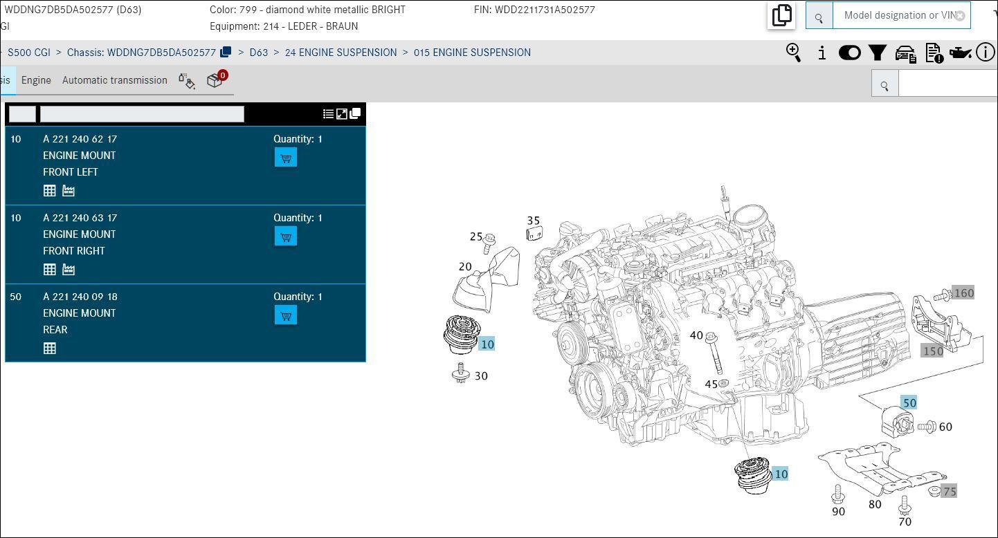

Well took it to MB and they determined it wasnt shifting correctly. turns out it was low on Trans fluid. will need mount an eng mounts too. they refilled transmission. confirmed no codes . Drive much better now. will do mounts in a month. Gonna order 255/45zr18 103Y XL Conti tires, Turn out it is a std model even though it has paddle shifters and vin decoder says it has the AMG transmission, it came with 18 in rims not the 19 in sport model rims

yep, I thnk FCp euro can get them as well as import carparts,com
