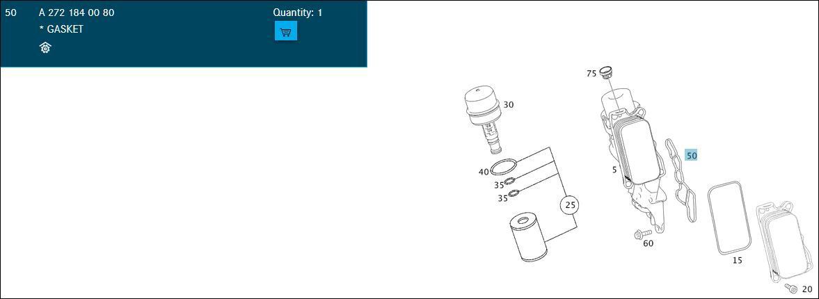

I replaced my oil cooler gasket about a year ago. Simple job overall.
Now it looks like my oil filter housing gasket needs replaced as it is seeping.
Any tips on a 2010 S550? Any complications I should know about before attempting.
I'm planning to do this myself unless I get guidance which says otherwise.
Thanks
Tom

Originally Posted by Audiomikej
I just pried off with flat blade screwdriver. If you're using Mann filters it should come with all three o-rings, super easy.
I doubt he is asking about the o-rings related to oil filter change, taking into account he says the oil cooler gasket job was easy.

Diesel Benz,
you are correct. I am asking about the gasket between the filter housing and the engine.
The gasket part number is 2721840080.

Better with some glue

See attachments.
File Type: pdf
File Type: pdf
File Type: pdf
File Type: pdf
