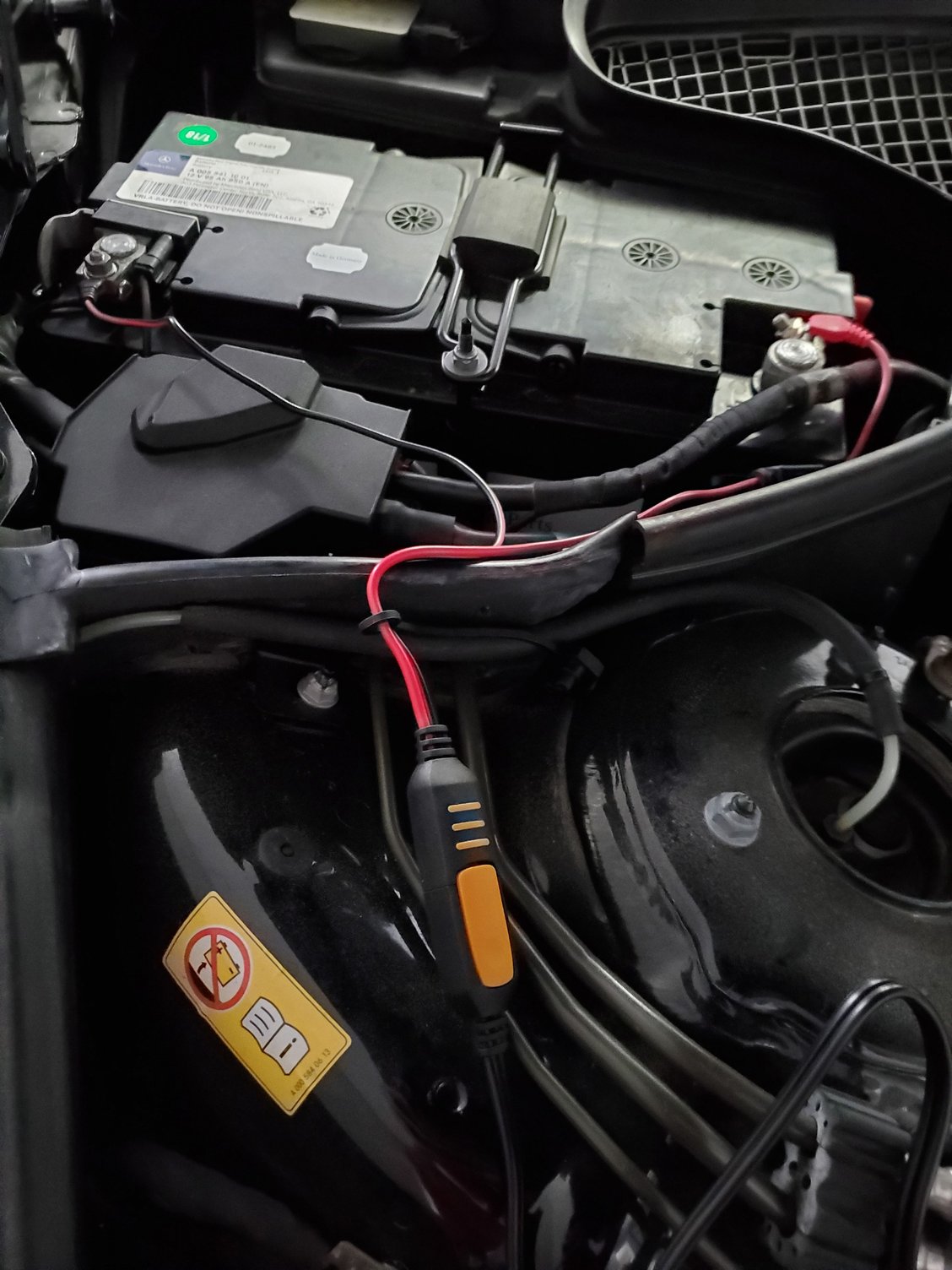

This is how I keep mine charging. Also via under the hood battery....

Someone is going to complain you connecting ground to the battery pole instead of chassis ground. I'd say either way is fine because this is a maintenance charger and only charges the battery when the car is parked. In this case the car is not monitoring battery charging via the sensor at the ground pole anyway.

Lol I am sure but you stand corrected sir 👍

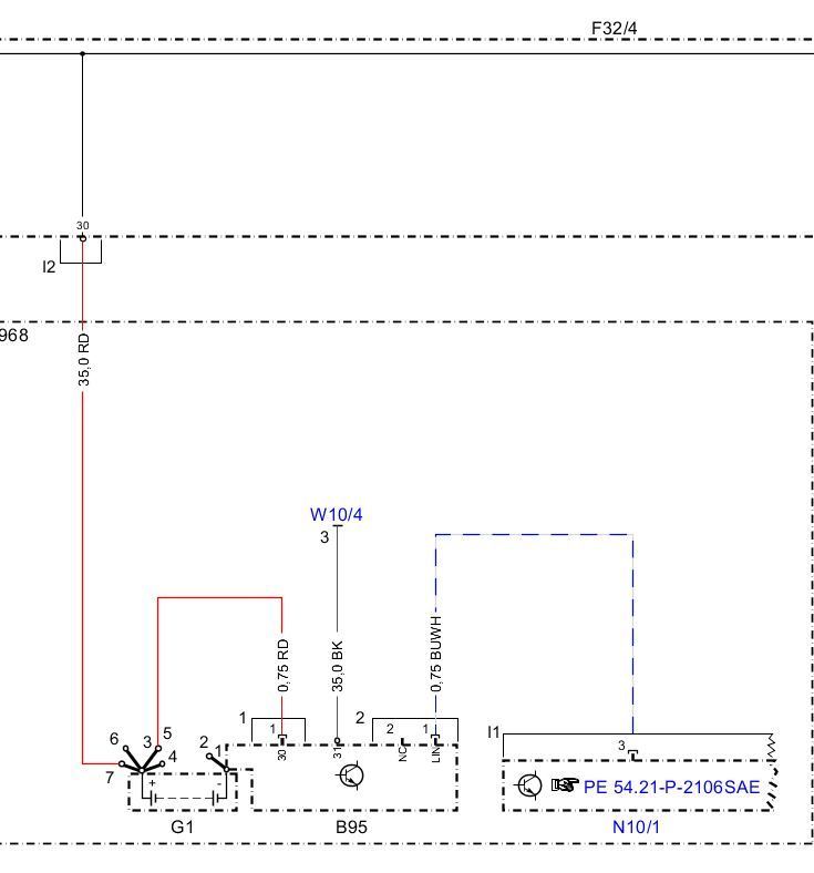

I didn't know this would be so difficult to so many on the forum. The chassis pole is not connected directly to the battery negative pole. There is the B95 battery sensor in-between. A very low resistance device but the usual argument is that the car is monitoring battery charging and if you charge the battery "from pole-to-pole", the car cannot measure the charge current to the battery. This is a problem sometimes but mainly if high current consumers were connected to the negative pole, like high power after market audio amplifiers that are used while the car is driven.
See B95 on the diagram. B95 is the small sensor attached to the battery negative pole. The battery ground wire is not connected to the negative pole but the B95 sensor.
EDIT: having a second look after the comment from kevm14, the diagram has a constraint telling the ground side sensor is installed only on specific models, pre-facelift and facelift.

I can tell you the rear battery on a pre-facelift W221 is grounded directly to the body. However it looks like the positive cable comes from some module and I'm not sure what that module is. But since it's on the + side, I would just connect a charger directly to the posts, for the rear battery, since there is no ground side monitoring.
