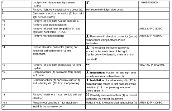

Hi guys, I have been thinking on removing my gray headliner for a black suede one from the S63/S65. I have the Panaromic Sunroof so getting all the parts together as we speak. I have been looking on line for any videos of the removal but no luck. Anyhow I can't see it being very hard but was wondering if any of you guys have removed one before and have any tips. I will be more interested on the removal of the front driver and front passenger seatbelts since I am swapping the side molding as well. So any tips will be appreciated. Thank you in advance.

This is for a 2008 Cl65 but should be similar.
