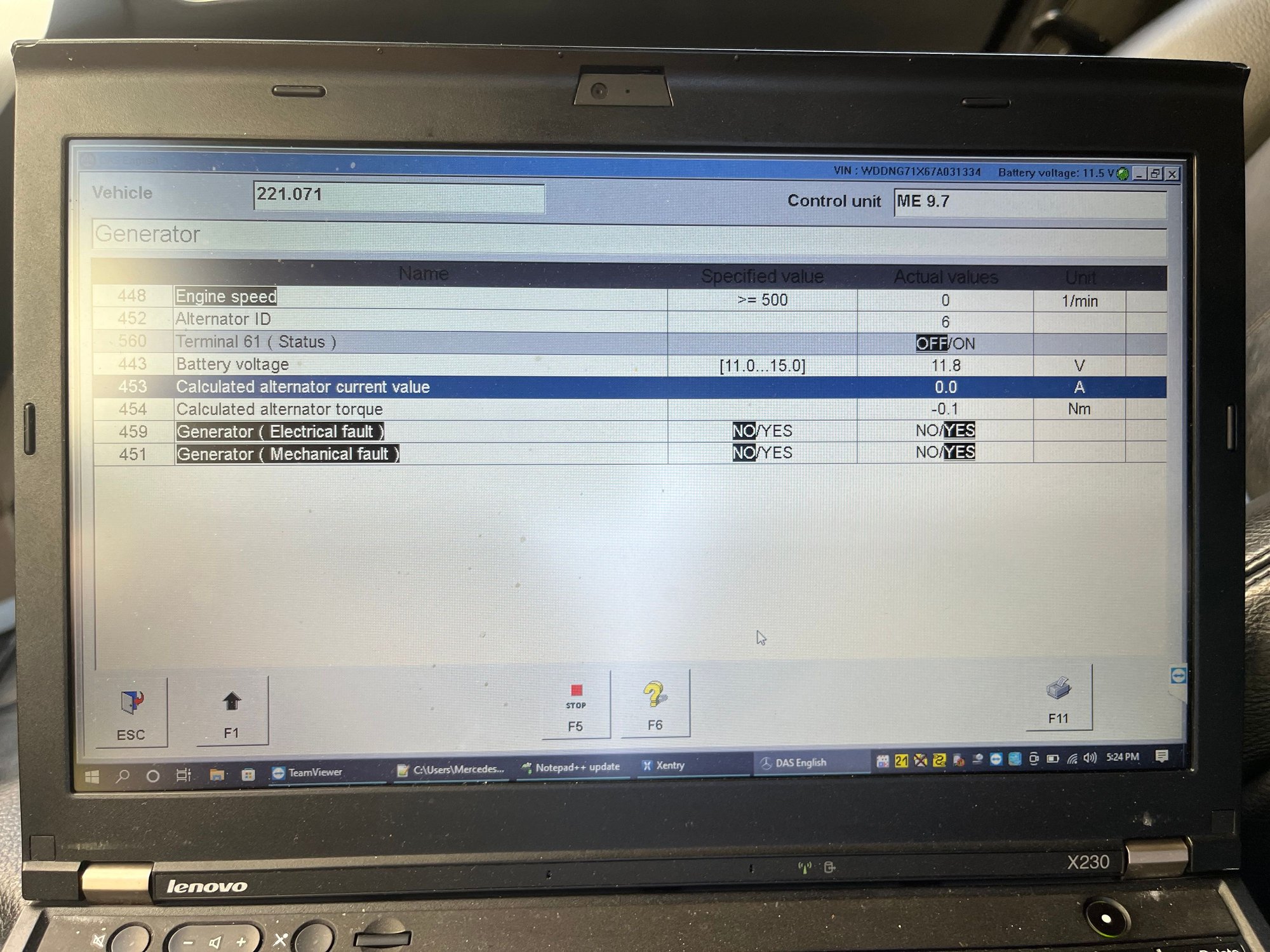

This is what help determine the faulty alternator along with other tests.

1983 Nissan Shltbox
Looks dead! Probably the most critical electrical component of a car. Should be gtg after the new "Dynamo", as they say in Deutschland

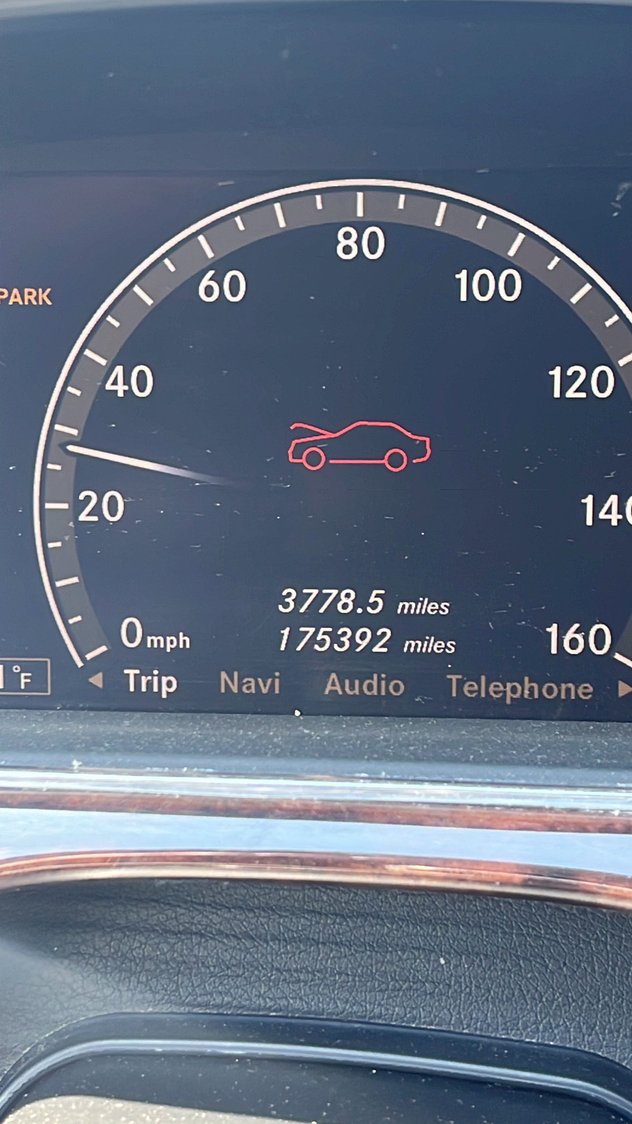

Hello all,
I promised an updated here it is. I picked up the car finally as I left it with my mechanic so that he could drive it for a few days to make sure that it had no issues. Well it passed with flying colors as far as the car starting up and also no battery issues. The starter was warrantied as well as the v4 group battery. All I paid for was for an alternator and labor for installing it which was $800 total. Now of course driving home I had an issue with the hood sensor. The hood was closed for sure but the instrument cluster said otherwise. I attached a picture for those want to see it. It seems that the hood sensor or the locking mechanisms for the hood are faulty. I ordered all the necessary parts to fix it along with new release cables. I had to depress the metal contact on the hood sensor to stop if from constantly alerting me that the hood was open even though it wasn’t by just using a zip tie. Hopefully no more surprises for me as I intend on driving the car to Florida on Saturday morning. Thank you all for the help and encouragement to get this car fixed.

Awesome! Can the hood latch/sensor not be adjusted to fix the dash indicator? New parts is cool too though, these cars are aging.

To be honest the parts were cheap enough to just buy brand new. 175k miles on those parts was good long enough lol. Headed to Disney my son graduated highschool and at the same time graduated college with an associate degree at the age of 18 so he deserves this trip. I figured it would be nice to drive down with the entire family.

I did a 2700 mile Disney trip with zero issues though my car had less than half those miles. Normally I'm the guy with the high mileage cars; this is one of the lowest mileage cars I've ever purchased.
On my E55 the hood latch sensor sort of falls out of its spot and this causes a similar warning. I ordered a new sensor but it seems like the tolerances are not great because it still slipped out of the mounting location. Ended up shimming it tighter with a cut zip tie and haven't had an issue since. No idea if the W221 uses a similar sensor design - never looked at mine.
