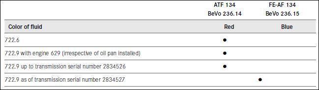

Hi Gents.I'm scheduling a B8 service and need to change the oil at the gearbox, with the following number 722967 03 226694. Is it right then I'm ordering oil according to specification; MB 236.15 ? Good evening.

Use the operating fluids site, formerly known as the bevo site. https://operatingfluids.mercedes-ben...ry/gear-oil/en

Check for option code A89. That will coincide with the updated 722.9 that requires the 236.15 lower viscosity fluid. If you do NOT have code A89 then you need to run the 236.14 regular fluid (i.e. ATF 134). This is important so don't guess. This changed somewhere in the 2010 model year for the US market I believe. Not sure about rest of world. I believe it also generally coincides with the facelift but I don't think it is exact if you are on the edge.

Thanks I have the following; A89 REDUCED-FRICTION - so as I can see from you're answer I can go for the 236.15 oil. Thanks - good evening.

That is correct.

236.15 is correct.
