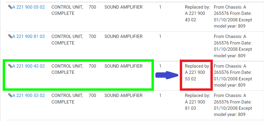

The amplifier in the car is dead, and cannot be repaired (OEM-A2219004302).
Interested in purchasing one, but there are several similar amplifiers, and I don't know which model would be suitable to replace the original amplifier.
I have attached a photo of the vehicle's technical specifications.
Does anyone know which amplifier is suitable to replace the A2219004302?
It is really urgent.

Provide VIN.

WDD2211561A351607

Shop 2219005302 or current 2219008103.
