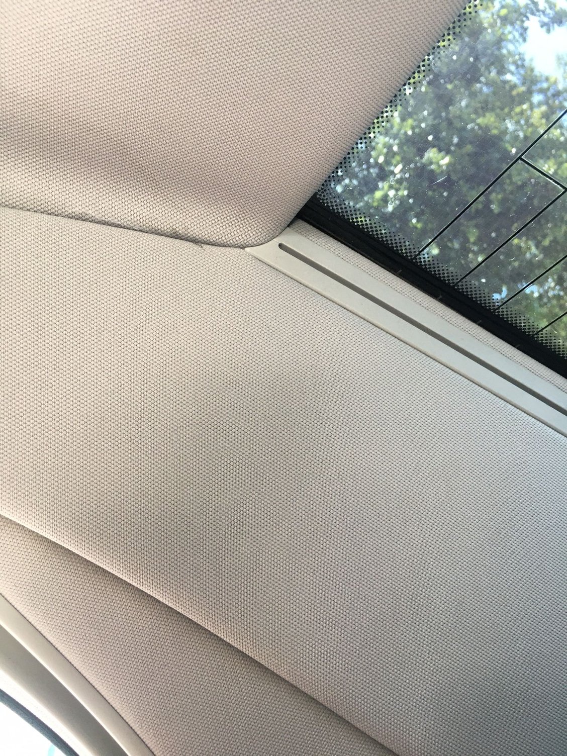

Experts, how to remove rear pillar trim so I can pull down the headliner for sunroof leak repair? (Not a pano). I've pulled it out as pictured, do I just use a brute force next or there is some clever ways to unhook the rest? There is a shade rail in the back as well.
thanks!

See attachments.

Perfect, this works, thanks @konigstiger
