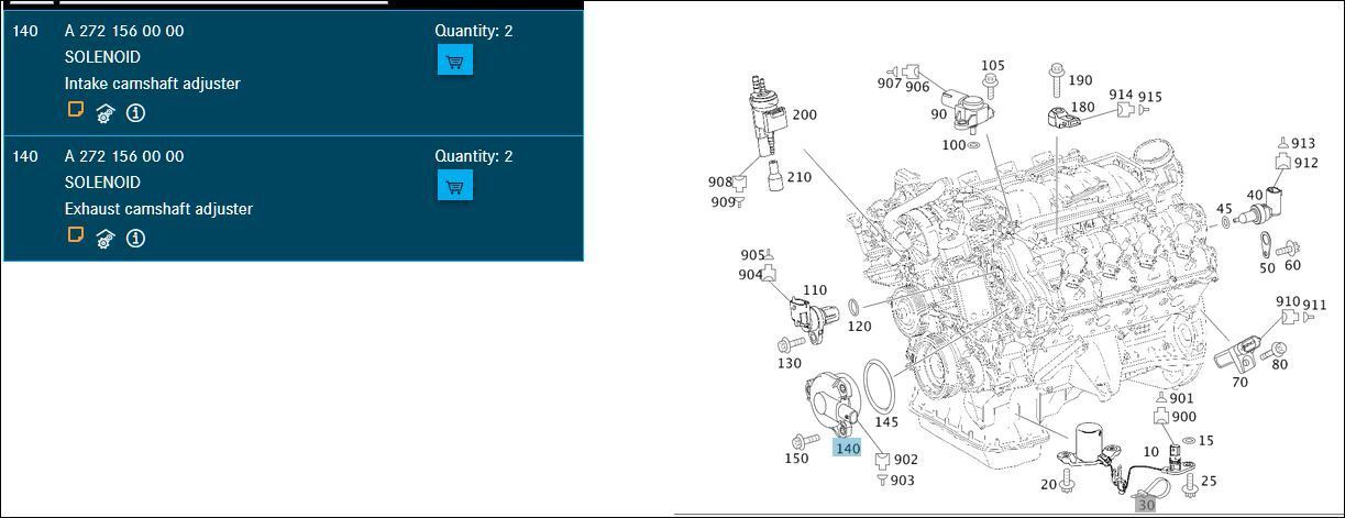

Originally Posted by chassis
The vehicle has an M278 with codes and leaks. @sHocKR3P4IR please explain how you or your mechanic have concluded the chain is stretched.
Ignore leaks, they are not the source of codes. Leaks on M27* engines are from poor factory quality control, do not cause codes, and can be repaired by the dealer.
Codes are caused by the ECU thinking something is wrong.
- Focus on the easy things first: cam position sensors and cam solenoids allowing oil to enter the harness. This is the least expensive and most likely failure - 2012 was the first year for M278 in W221 and therefore has the most time on the road/in use. Cam position sensors have had a multitude of part number changes which is a red flag that MB knew they had a problem and were flailing around trying to find a solution.
- After oil in harness has been affirmatively ruled out, move to mechanical parts: chain, tensioner and cam plates.
I would think that if I were to swap the camshaft adjuster and the camshaft position sensor from the malfunctioning cylinder bank with the other cylinder bank and see if the error code comes up again in the other bank, that would provide some information, right?
Possibly.
1. Tell the indy to check the sensors and magnets for oil leaks. 30 minute job.
2.a. If oil found, replace magnets and solenoids, clean the harness, clear codes and drive it for a while.
2.b. If no oil found, follow the MB documentation and dozens of threads on this site related to check valve installation, because your engine is in the affected range.
