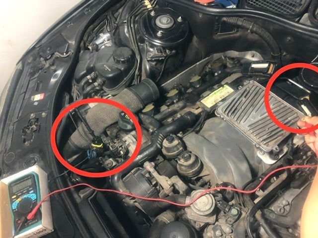

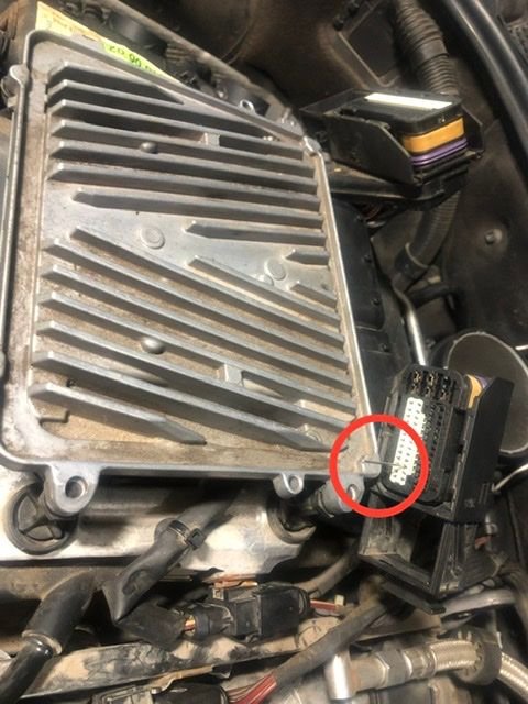

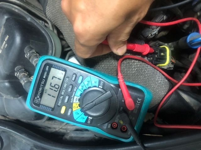

Fan has 04 wires:two big one connect to battery, the other small one is 12V powered when you turn the car ON, the last one is control signal connected to pin 43 of the ECU (small ECU harness) and fan will run max speed if control signal is lost.
12V main power and connected to battery
12v power when car is on
Pin 43 is fan control signal from ECU
You need to check conntinuty between pin 43 and the last terminal of fan
