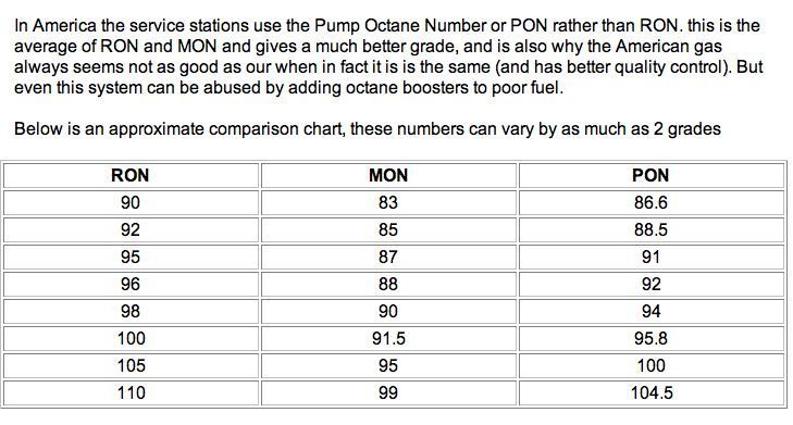

before we can correctly answer that we need to know what market your car was made for - USA use a different octane rating measurement system to much of the rest of the world and then seek to confuse people even more with 3 different acronyms and 2 measurements MON, AKI and PON for _ _ _ _sake - the two that region is supposed to use then under-reads by 4.5 wotsits vs normal people
the best source of info is your handbook that was written with the correct data for your specific car and is not some idiots on the internet telling lies - most data you find on the internet should be ignored
you should NEVER use less than the minimum recco in the handbook - if you must - it should be only as a get you home emergency, and then you should drive gently for the minimum possible time on that fuel - as in light throttle settings and more revs vs large throttle opening and low revs, and avoid hills - the correct way to think about this is if your life is dependent upon moving the car try the what's available, otherwise park it - you could try mixing an octane booster but on a car of this type I would not be comfortable in getting things wrong - the cost of wrecking a good car is a huge amount of money -

Thank you for your answer. I've read your replies in other threads and you seem to know gas well.
My car is US-spec so I derive from your chart there that my 91 PON is equivalent to a 95 RON when my vehicle gas cap asks for a 98 RON, minimum 93. Am I interpreting this correctly and if so, should I be octane boosting my 91 PON?

I added more ramblings to my post above - yes I agree with your thinking USA 91 is about European 95
but you should use in you car 93 which is European 98 - this is a premium grade fuel that is a lot more expensive - nearly one US dollar more per funny US gallon - as its made using higher quality detergents and anti-knock additives. And the car will drive faster, smoother and happier with lower fuel consumption on this fuel
anti-knock is the main feature your high tune car is seeking to control from that high octane fuel requirement- the more boost (from the turbo's) the more the risk knock will cause harm - knock, AKA pinking, is the shrill metallic tinkling noise you can hear on a hot engine working hard under tough conditions - it really comes from the change in burn rate inside the engine - from a very fast controlled flame front creating high cylinder pressure and high performance to the catastrophic explosion that melts or burns holes in the pistons.
its quite surprising that the car's engine management can't just provide less performance and protect itself when using sub-optimal fuels - but they (Mercedes) tuned it up and they should better understand why they haven't provided that fall back position thats safe for cheap fuels

Thanks for the chart, is it possible to include AKI in the comparison as well? Thanks!

AKI (anti knock index) = PON (pump octane number) - as you measure Knock resistance in the USA using a slightly better MON test routine (rather than the ridiculous European RON test) and are quite comfortable to then choose to call it by another unit system at the pump - why not just call the stuff at the petrol station RON as well and we can all sleep happy and stop squabbling around the world ?
