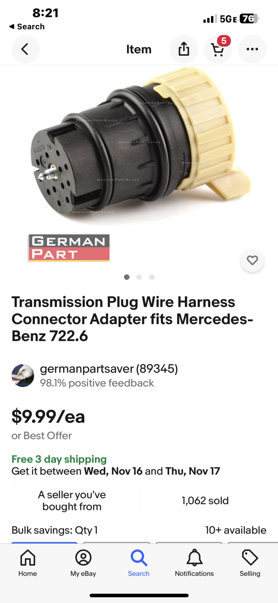

About a month again one of the pulleys on my engine broke which cause the serpentine belt to shred in pieces and of course left me stranded in a parking lot. I had the car towed to my mechanic where he replaced the pulley, crankshaft seal, and pulley. When I picked up my car I noticed that the check engine light was on. I immediately texted my mechanic to tell him about the light. He said that it was a transmission code. Shortly after putting the car in gear it bucks or jerks. It does not slip or do anything while driving. While driving away from the shop I noticed that the car seemed to be stuck in 1st gear or 2nd gear. I ended up getting to work and 8 hours later I was driving and of course it still felt like the car wasnt shifting gears. Within a mile of driving the ac compressor pulley exploded and again I was stranded on a road as the serpentine belt once again shredded. I had the car towed to my house this time as it was 6 pm on a Saturday. When I got home I tried to scan it and noticed that there was no communication with the transmission module and scanner. The rebuilt transmission has 12k miles on it and 13 months ago was rebuilt. The valve body is 3 years old.. ninjabenz who is excellent suggested that it might be the conductor plate plug that might have gotten oil in it. I have another person who works in service department of Porsche who said it might be fuse. Any help would be great. Before the comments about get rid of the car I will say that this car is sentimental value and that I would try in reason financially to keep it. Attached is what ninjabenz said to replace.

This harness is for 722.6 and not for your car, you need to check transmission wirring harness first, rarely case that conductor plate faulty and completely no communication unless wiring issue.

Yes, I misspoke their ninjabenz suggested they part it was another person. Is there a plug for that? Is it possible that I can use the star to scan it?

Pull codes. Figure out why you keep shredding belts. Benzninja is probably closest, that plug gets oil in it and the car starts glitching. Common issue. With random grease monkey hands under the hood though, there's no telling. Pull codes.
