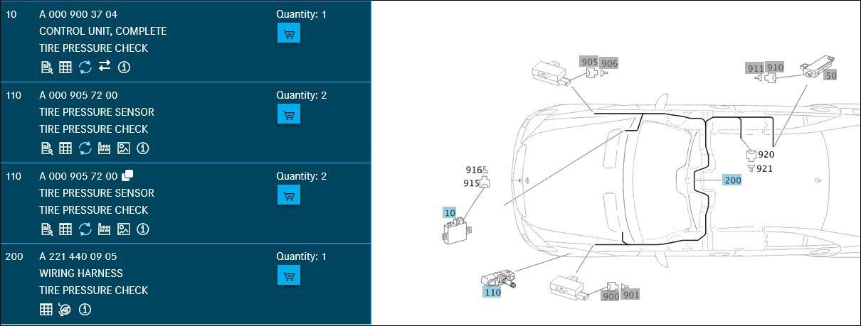

Trying to get a handle on what scenarios would cause my 2013 W221 S550 to not even see the TPMS modules even though they can be successfully activated. I get green all the way around on my scanner when activating them, but the car cannot find them at all.

If you’re referencing wheel sensors they should be 433Mhz. Malfunction scenarios: sensor frequency may be wrong, internal batteries at the end or nearing end of life span, CU needs replacement with worst case being failed harness. Find someone with Xentry (MB diagnostics) to erase stored codes & run quick test.

Thanks for the feedback. Using the process of elimination my next step would be control unit replacement. Is there reprogramming required for that?

If new it needs to be activated via Xentry, used more time than not plug & play. Before replacing check f96 (5A) @ side dash if fine pull for several minutes in an attempt to reset you may get lucky.
