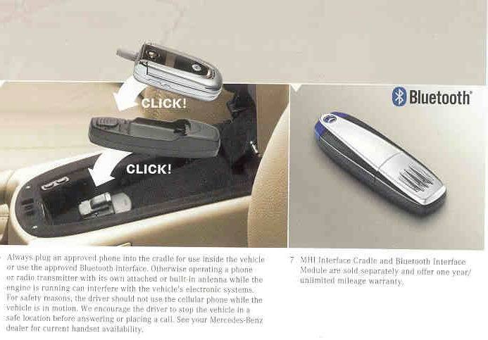

This is how bluetooth telephony works in your car. The latest dongle is all black. Note: this is for telephone only, as bluetooth music from phone didn't exist until 2016 and iphone6
It's German, so it goes "CLICKEN!"
I gotta get me one of those flip phones. Is it an actual Mercedes phone or just an old Motorola or something?
