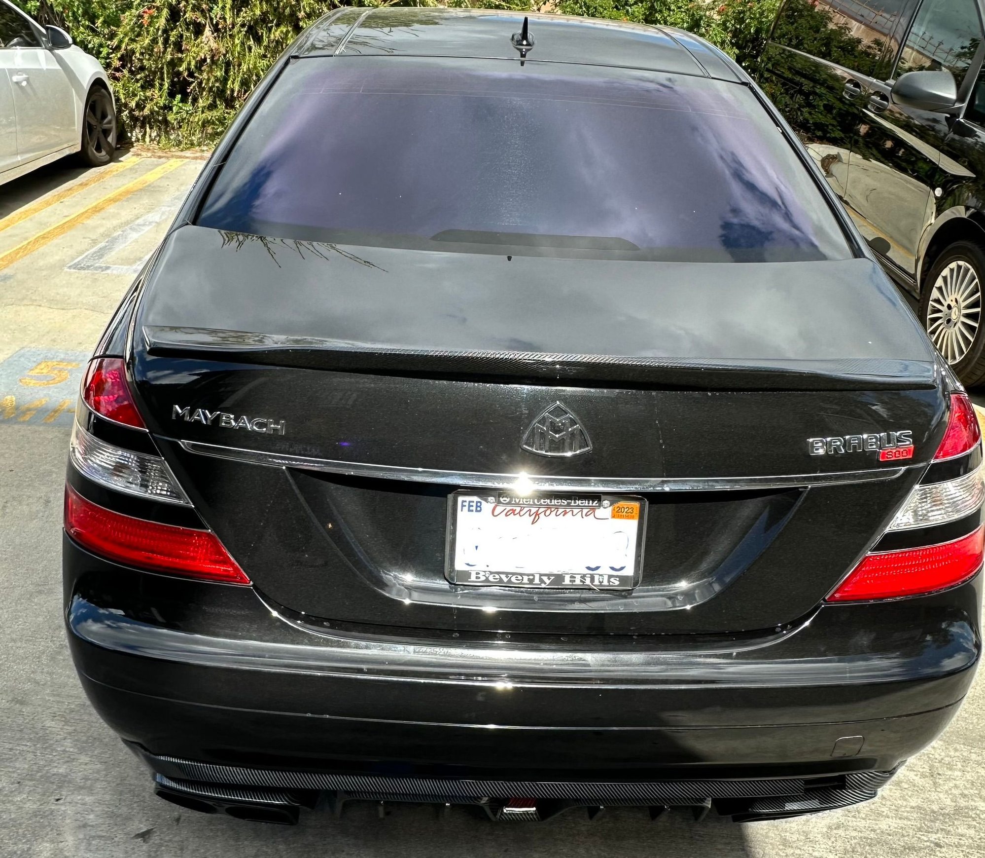

How to tap in power source for the Brake light on diffuser
How do I connect the light on diffuser as a Brake light ?

I would tap off of the CHMSL and make sure the diffuser light is a low wattage LED. You still might get a dash message about your bulb though. If that happens, you can use a relay with a power source in the trunk.

Chmsl- what is that? And where is the power source in the trunk? Thank you for taking ur time and responding!! I appreciate it!

Center High Mounted Stop Lamp. It's the one in the middle on top of the package tray. The power source in the trunk is the fuse panel behind the rear seat. Different years had different configurations. I wouldn't mess with it unless the tap from the CHMSL doesn't work properly.
