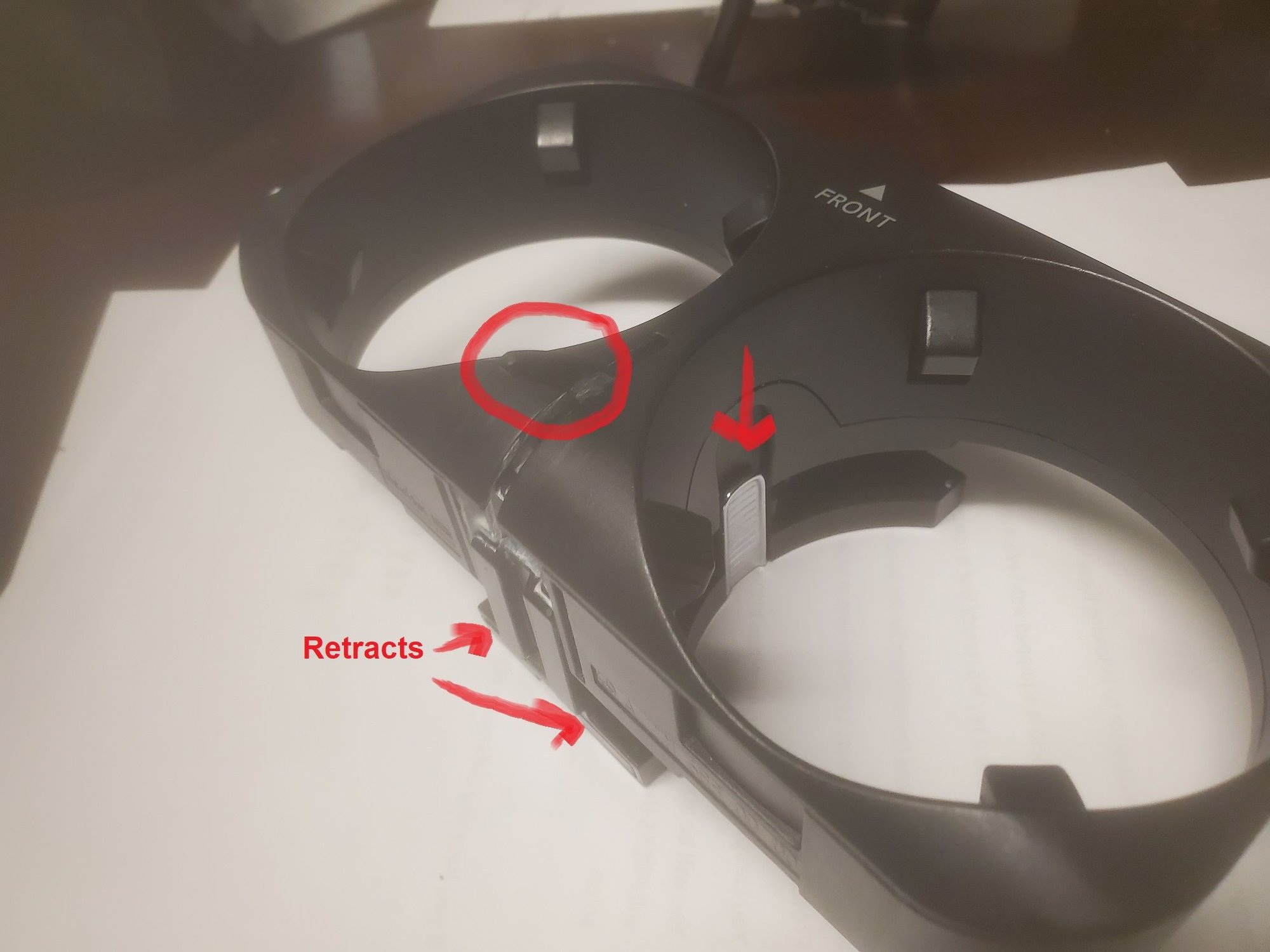

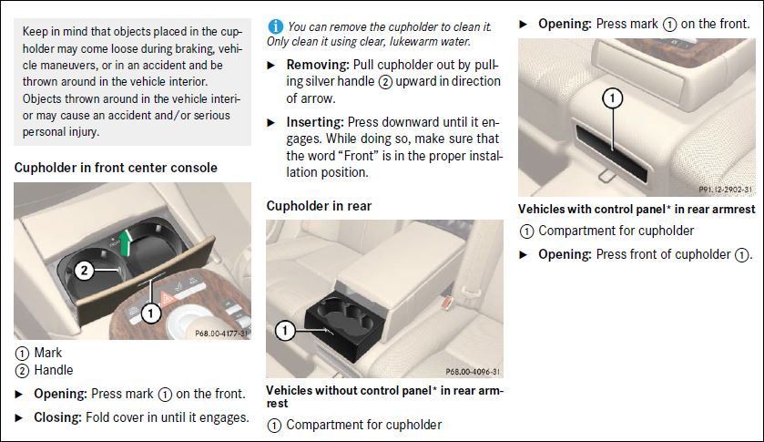

New owner of a 2008 S550 and love the car. Driving home from purchase 3 weeks ago, I noticed the cover over the cup holder wouldn't close. I didn't want to force it so I just left if. Fiddling wit it later, it still won't close so I took the insert piece out. It took some wiggling back and forth but finally came out. I didn't feel anything snap or break so I don't think I broke it. Apparently, (read the book afterwards) I was supposed to pull up on the shiny metal things (see arrows on pic). Now that it's out, I can see pulling up on the shiny metal causes plastic parts on both sides of the "feet" to retract a bit.(arrows)

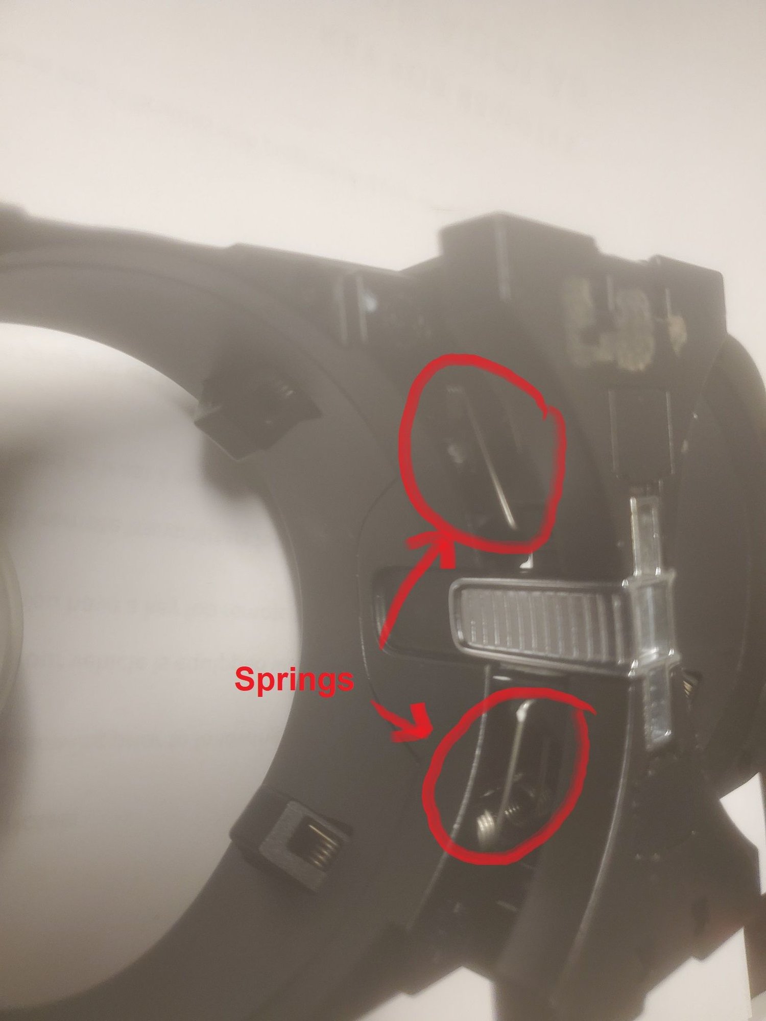

There is also a lever (circled) on top that moves back and forth but doesn't do anything. Underneath, it appears to have a spring like suspension of sorts. Some white grease is visible where it looks like the feet would go up into the unit. It would seem like pushing down on top of the whole unit would compress it down, but there is only a tiny bit of movement and something is restricting it.
See pics for circles, arrows, etc.
Backing up a bit. What exactly is the cupholder supposed to do? Should it pop up when the lid is opened? Is the lever a sensor or latch that allows it to pop up? Is this "latch" broken inside or what?
Any suggestions?

I read the same thing in my book. It doesn't answer my questions. Why would the lid not close? What is is supposed to do?

Does not pop up should sit flush so door can close properly OM explained this by not emphasizing pop up. Anyway, you may need to repair/replace cup holder.

Perhaps "pop up" is not the right terminology. Does the cup holder rise up when the lid is open. I've been experimenting with it sitting here at my desk, gently moving the lever back and forth while pressing on top of the holder. It then, with minimum pressure it started to move up and down easily. This leads me to think that closing the lid pushes the lever which then allows the cup holder to be pushed down by the lids.
While it was making it go up and down, I picked up my phone to take a picture in the up and down position with about a 1/2" of movement. Of course, the minute Ii had the phone in my hand to take a pic, it locked up again and I can't make it go down.

Yes. The cup holder module does slowly rise about 1.5cm when you open the lid and lowers when you close it.

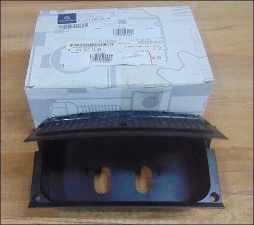

I've had to replace the part number 180 above as one hinge had broken and it was sorta lopsided.
Know that the cover that matches your interior simply pops off, so no need to order that. Just pop it off of the broken box and attach it to the replacement.
