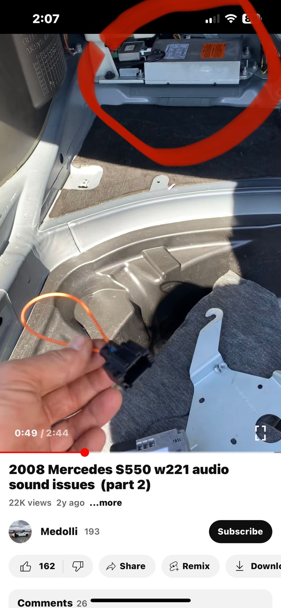

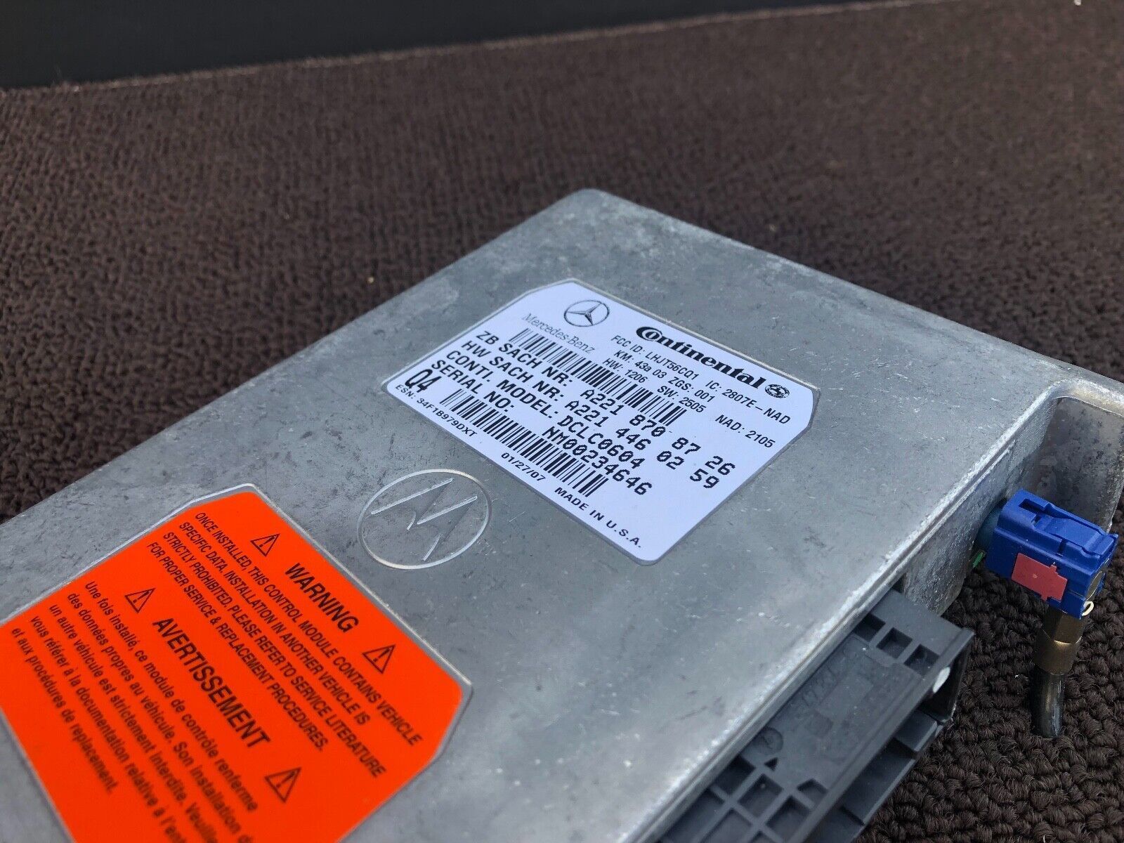

This is the module I am talking look at. I am not sure it has fiber optic lines going through it or not. I circled it.
Old May 28, 2023 | 02:34 PM
JohnLane's Avatar
Joined: Feb 2012
Posts: 2,641
Likes: 1,224
From: Phoenix
222 S-65
Seems like in my car it was further to the left behind the panel that goes fore/aft. Have to remove panel for battery access first. In the photo it sure looks like someone is holding a fiber loop used to bypass a component in the loop.

that pic makes it look huge - lots of stuff no MOST from the looks of it
Old May 28, 2023 | 06:27 PM
BOTUS's Avatar
Joined: Aug 2014
Posts: 5,322
Likes: 1,678
S500
two other modules on fleabay with different connections but first one looks like a bluetooth module
2007/2008/2009/2010/2011/2012/2013/W216/ CL600/CL63/CL65/CL550/S600/S63/S65/S550/S450/W221 Interchange Part Number 2218705787 Fitment Type Direct Replacement Brand Mercedes-Benz Manufacturer Part Number A2218705787 Other Part Number A 221 870 57 87
07-14 Mercedes W216 CL63 S550 Voice Language Communication Control Module OEM Part Number #2218703887
