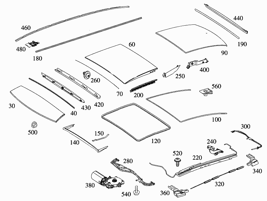

strange - no idea if u get drains this didn't help
https://nemigaparts.com/cat_spares/e...71/63v/78/150/

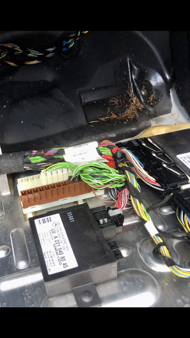

took a look under the aluminium plate that gets soggy below the HVAC blower motor in the passenger footwell
as you can see underneath the plate mine was giving me the needle - showing that its perfectly possible for detritus to make the leap from outside to inside - great design. I pulled off both batteries and remade all the connections then put back together with ACF 50 everywhere - as per the other chaps post I pulled the airtragic ecu apart (5 screws) to look at my circuit board before coating it all in ACF 50 as well - mine didn't have any corrosion on any parts - but you could tell the foot of the aluminium plate had got wet at times - must have at least 16 canbus links hiding down there - the beige and brown connectors with all the green wires... the carpet just pulls back and then three easy to reach 10mm plastic nuts allow the plate to lift back (here its lying on the floor in front of the seat squab) - oh - and a remade the two earth points for good measure
