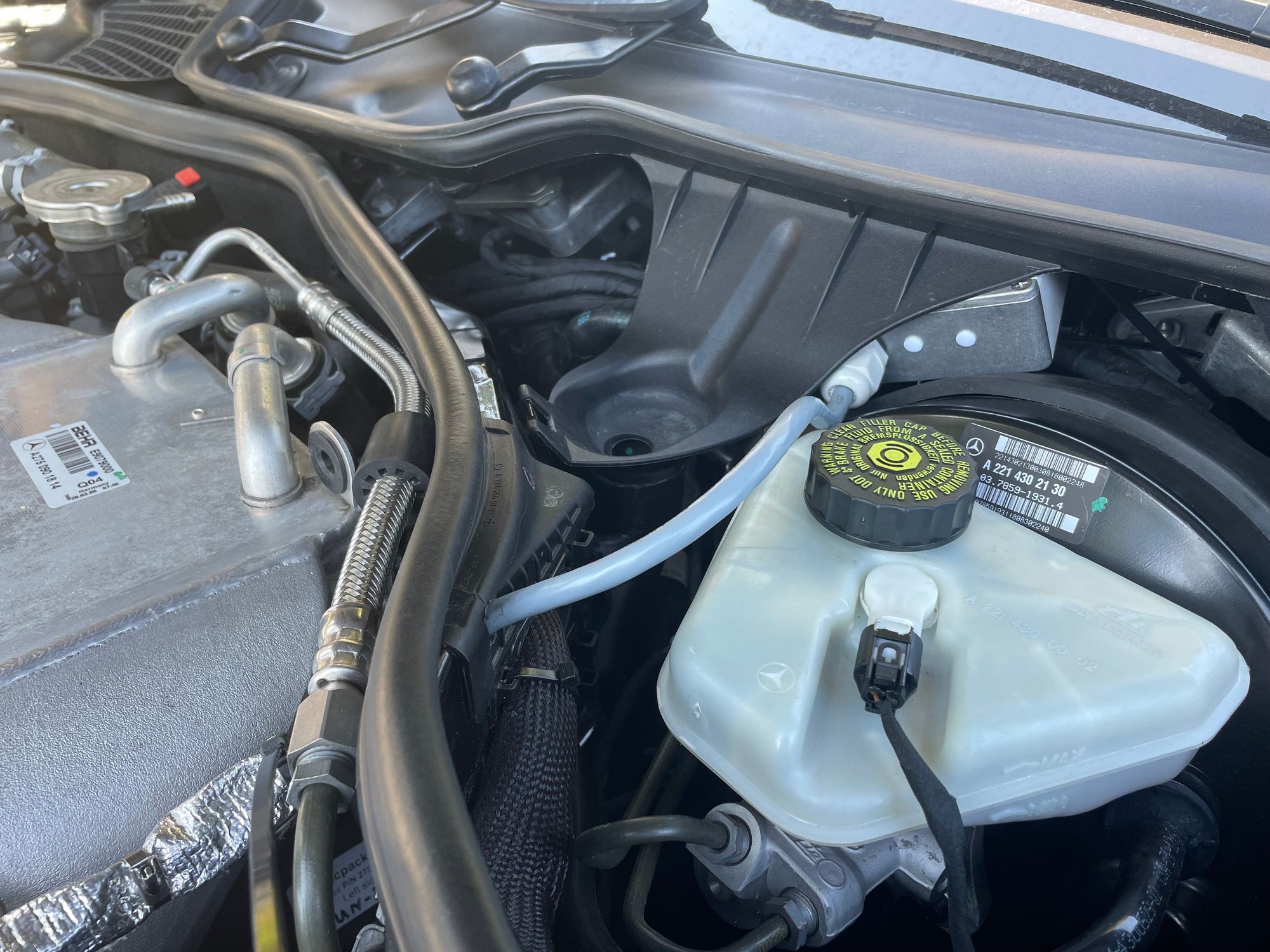

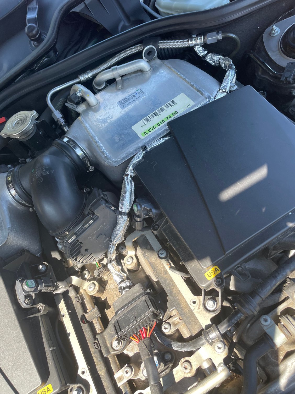

Old Jul 31, 2023 | 01:48 AM
johnnyrocket52's Avatar
Joined: Jun 2023
Posts: 190
Likes: 76
From: Portland, Oregon
2009 S600 V-12
Boost Box tie wrapped to Master Cylinder.
Heat wrapped cable into engine bay.
Originally Posted by johnnyrocket52
Thanks guys.
I'll look to get it mounted near the rear firewall later in the week.
I have both sides reworked coil/packs installed along with 24 new iridium plugs and the new VT boost box should be the icing on the cake.
Will get back with a full report.
Johnny
Completed the install of the new Boost Box today from Clark Rupp: https://www.v12icpack.com/
Mounted to the firewall, tie wrapped to the base of the windshield wiper motor. Windshield wiper armatures were very far away from Boost Box when operating windshield wipers. Heat wrapped the cable going into the engine bay. Car runs better? At least I feel better knowing the fused Boost Box won’t take out my new CPs.
Johnny
