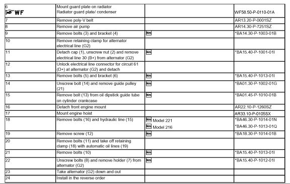

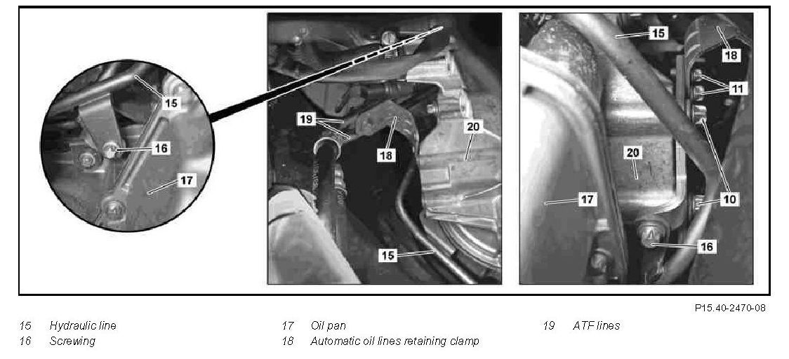

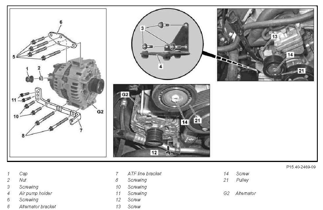

This is for the CL. Should help get you started.

Looks like some differences there. No need to mess with the engine mount and lifting the engine, for example. The 2011 is still the M273 right?
