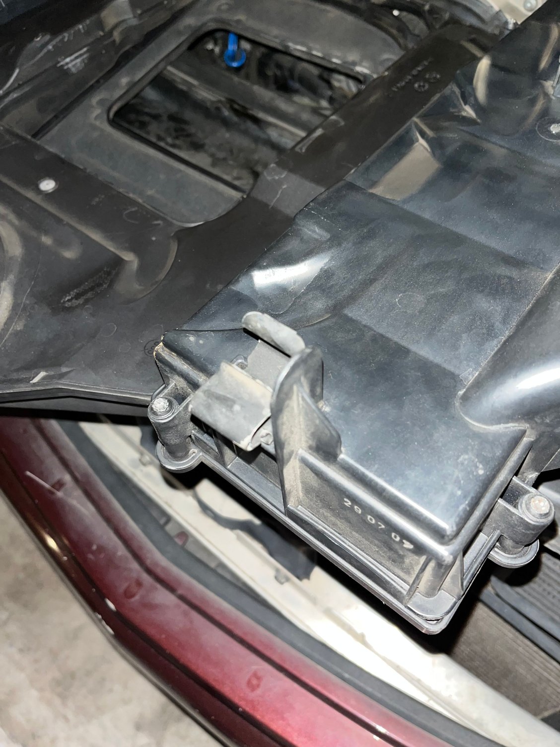

The rear clips on the air filter housing are bent and are not letting me fit the air filter housing properly. Does anyone know the part number for these clips?

part 260 but its then NOT listed to get the number - bend it straight - on the bottom picture just above - the top part is OK the bottom near the screw, is folder over (bent down .....up in the real world)

Get a pair of pliers and bend it to where needs to be. No need to buy new ones.

And put some lubricant on each of the rubber knobs that these clip onto it makes it so much easier to reinstall and remove in the future I have all of mine greased

a bit of silicon lube on the rubber to the throttle body / intake manifold - thats the main issue - user fight to slide over, and mangle the clips doing it all wrong

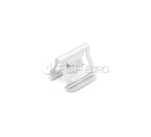

Not sure these are the same clips but I ordered these from FCP Euro to replace my clips on my 2007 S600. Hope this helps.
Delivered: Sun, Jul 11
Mercedes Engine Compartment Clip
MER-0119888978
Price
$1.39
QTY
2
