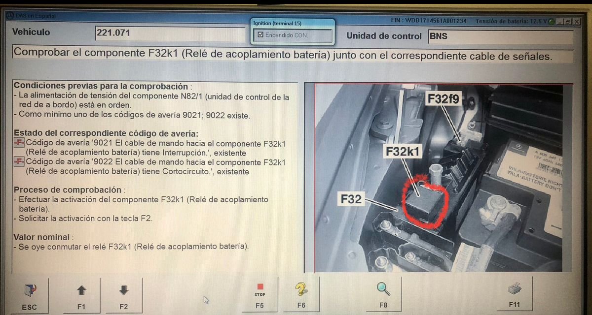

how to change this relay
Hello good Morning. greetings to all. a question. Does anyone know how to change this relay indicated with the red circle???? . any video on you tube or tutorial on how to do this job. I have looked for it but I can't find how to access this relay. I would greatly appreciate your help and advice. thanks a lot. Greetings from Spain.

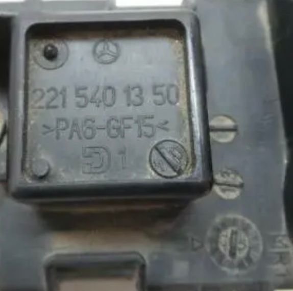

I typed that in ebay and got the whole pre fuse box
w221 2215401350
if its not a removable one I guess u do buy the whole lot

Thank my Lord. Botus. He thought that somehow you can just change the relay. hence my question. thanks a lot. all the best.

don't forget, if fiddling, disconnect the rear battery too (before shorting stuff out)
pictures on ebay do look like it might split apart around this very relay (and that might mean you can get at it) - BUT as so many secondhand spares out there - I guess if this is playing up / dead - a whole unit would be a sensible thing to have to hand - it, after all is not playing with low Ampage
