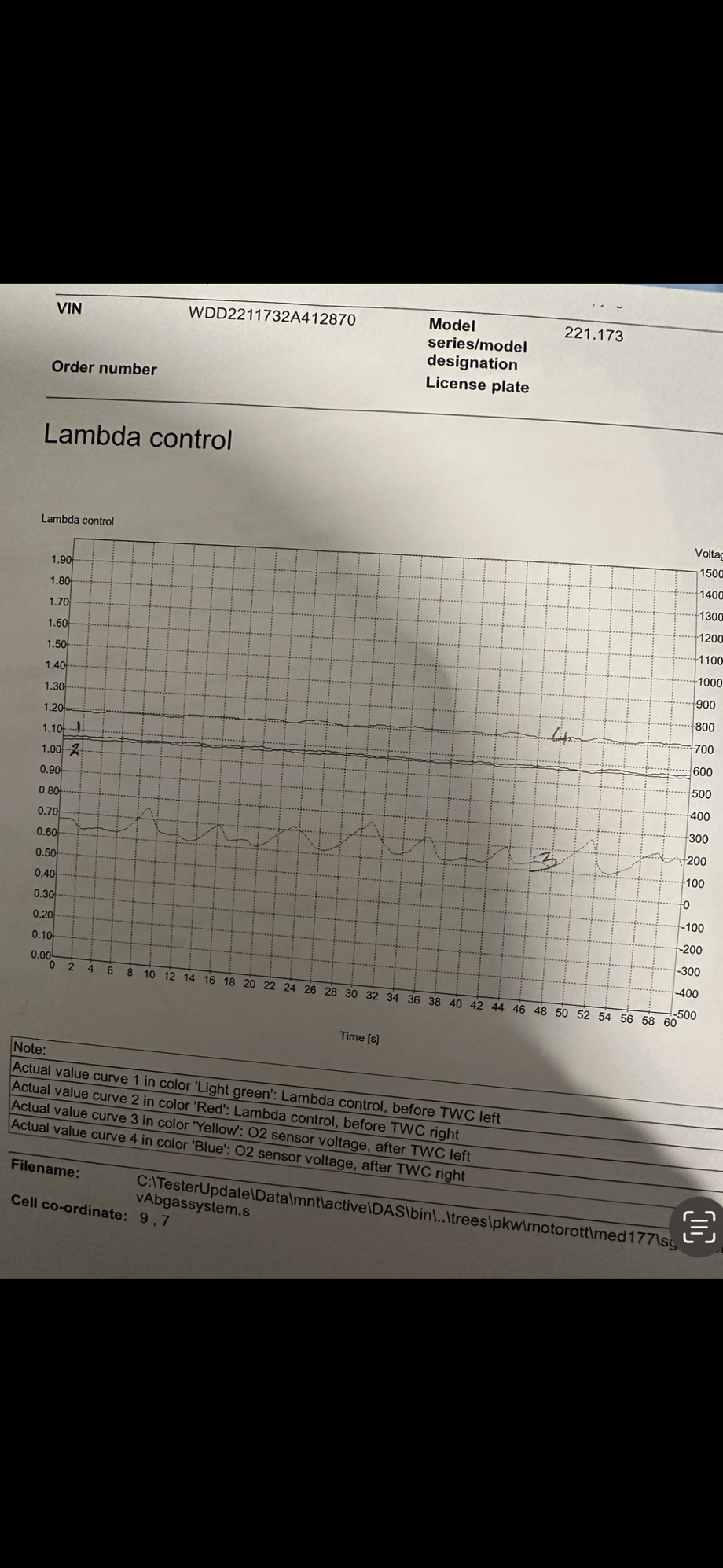

Ive recently noticed that my fuel consumption was deteriorating along with some slight white smoke from the exhaust so i decided to purchase a Foxwell NT301 code reader and sure enough my LTFT on both banks is showing + 20 % so I booked it in with my local Mercedes dealership for the full diagnostic treatment and they tell me that there is no CEL showing and they can’t find any faults with car whatsoever and they were even kind enough to give me a copy of the xentry diagnostic paperwork.
After looking through the xentry document I can see a substantial difference in the O2 sensor readings which must be the cause of my initial complaints to the mercedes dealership ?

Take it back and tell them NO its not normal according to the data they looked at . The two sensors are not matching up. Could be the O2 sensors or cat, but it will also need better diagnosis

This is even more funny because it clearly shows incorrect performance. And even if it was normal, why is the other not behaving the same?
