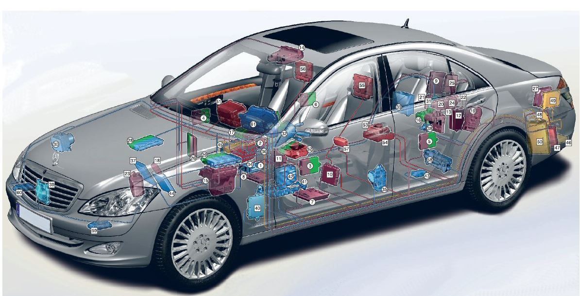

From: Brooklyn, NY
2007 S550 4Matic 2013 S550 Base

SGR is the small radars
the big central one is the DTR
that's not the full modules - looks like N62/1 (number 31) is in the right rear wing of the boot - even my drawing is missing the SGR's in both bumpers
