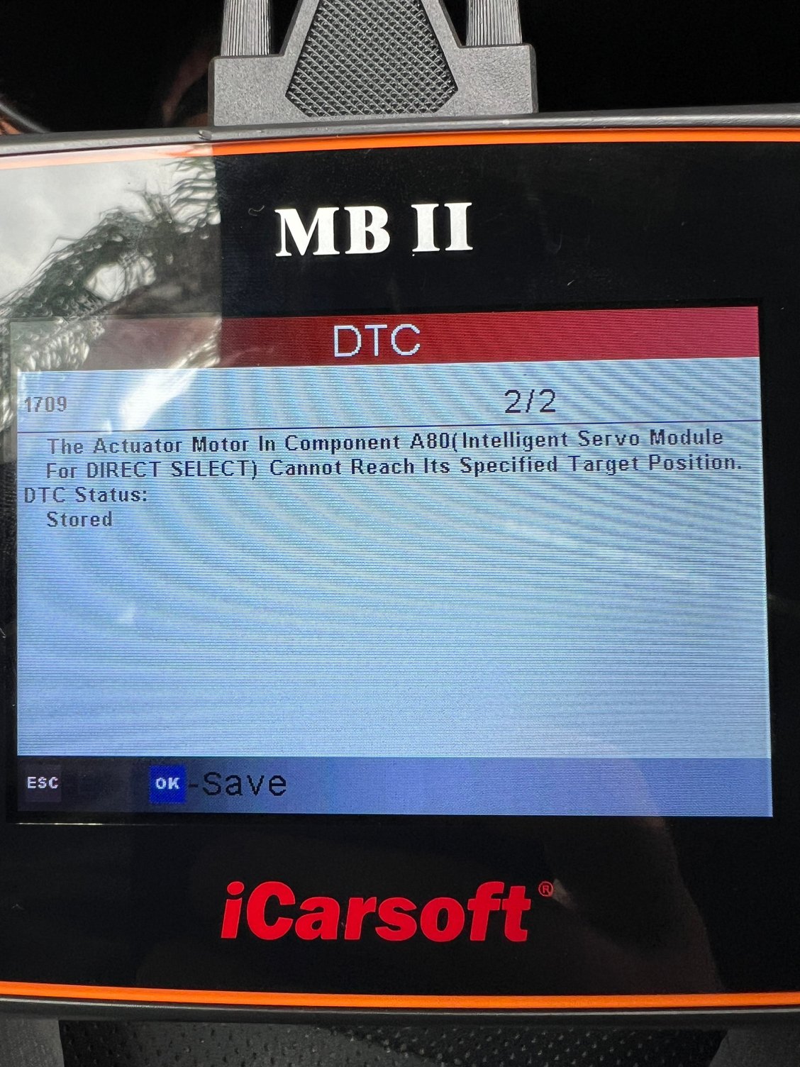

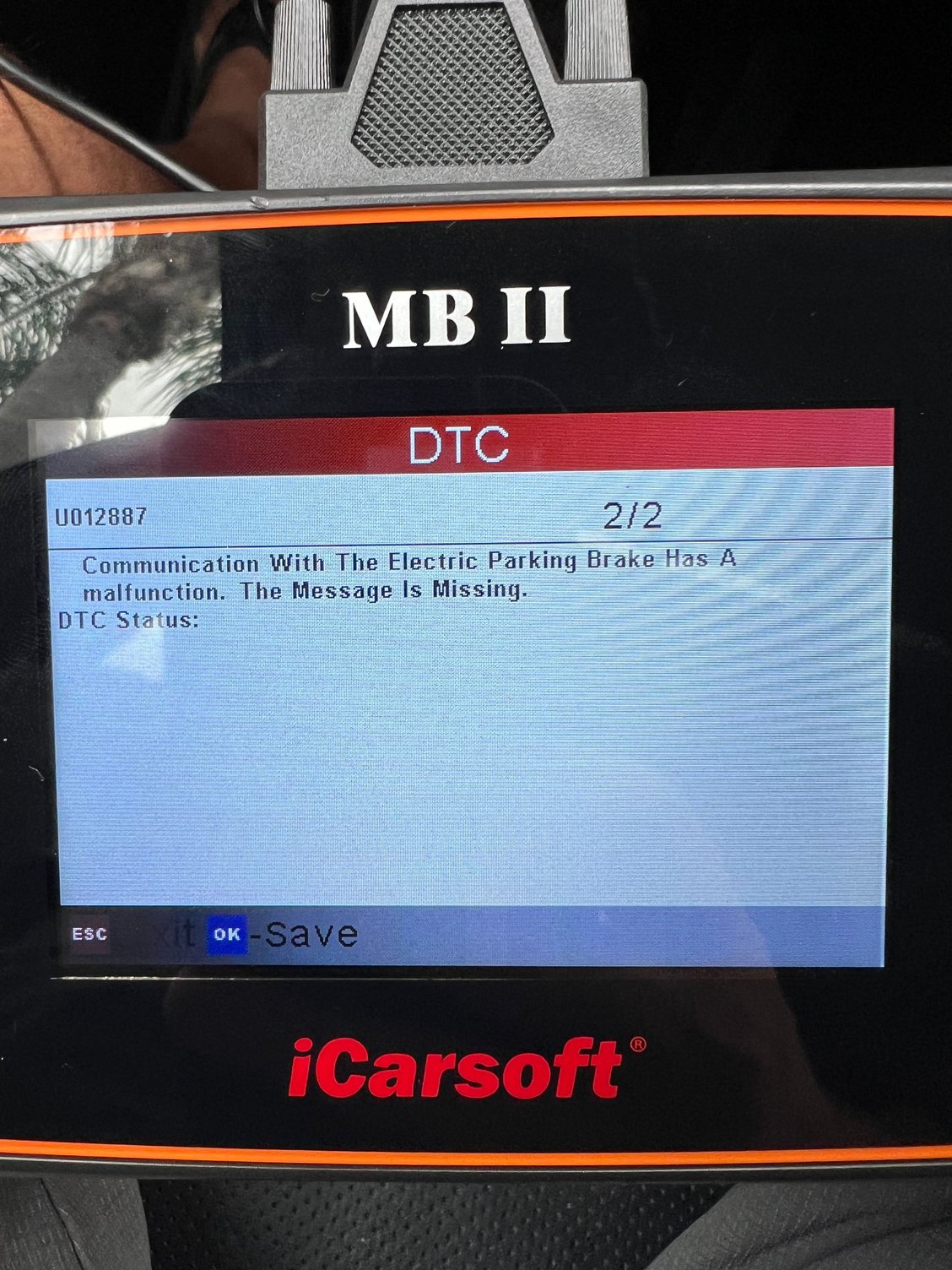

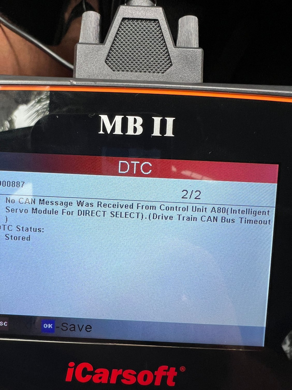

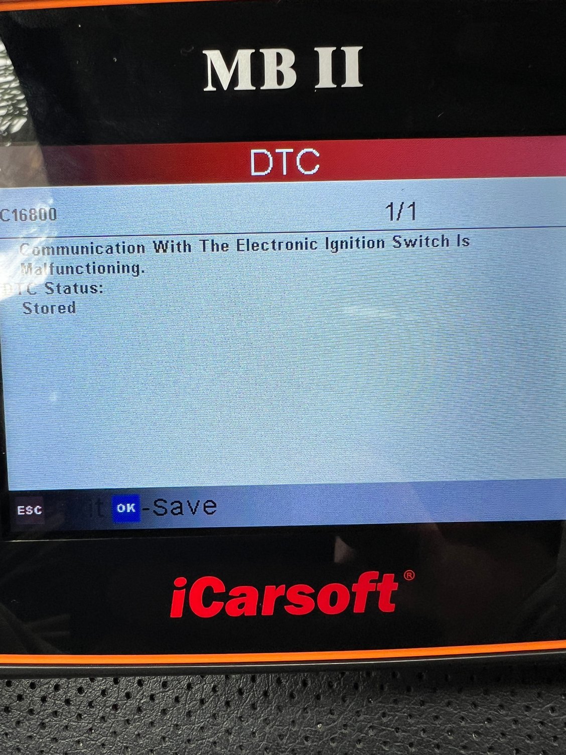

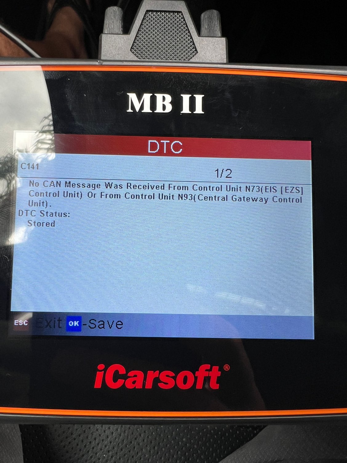

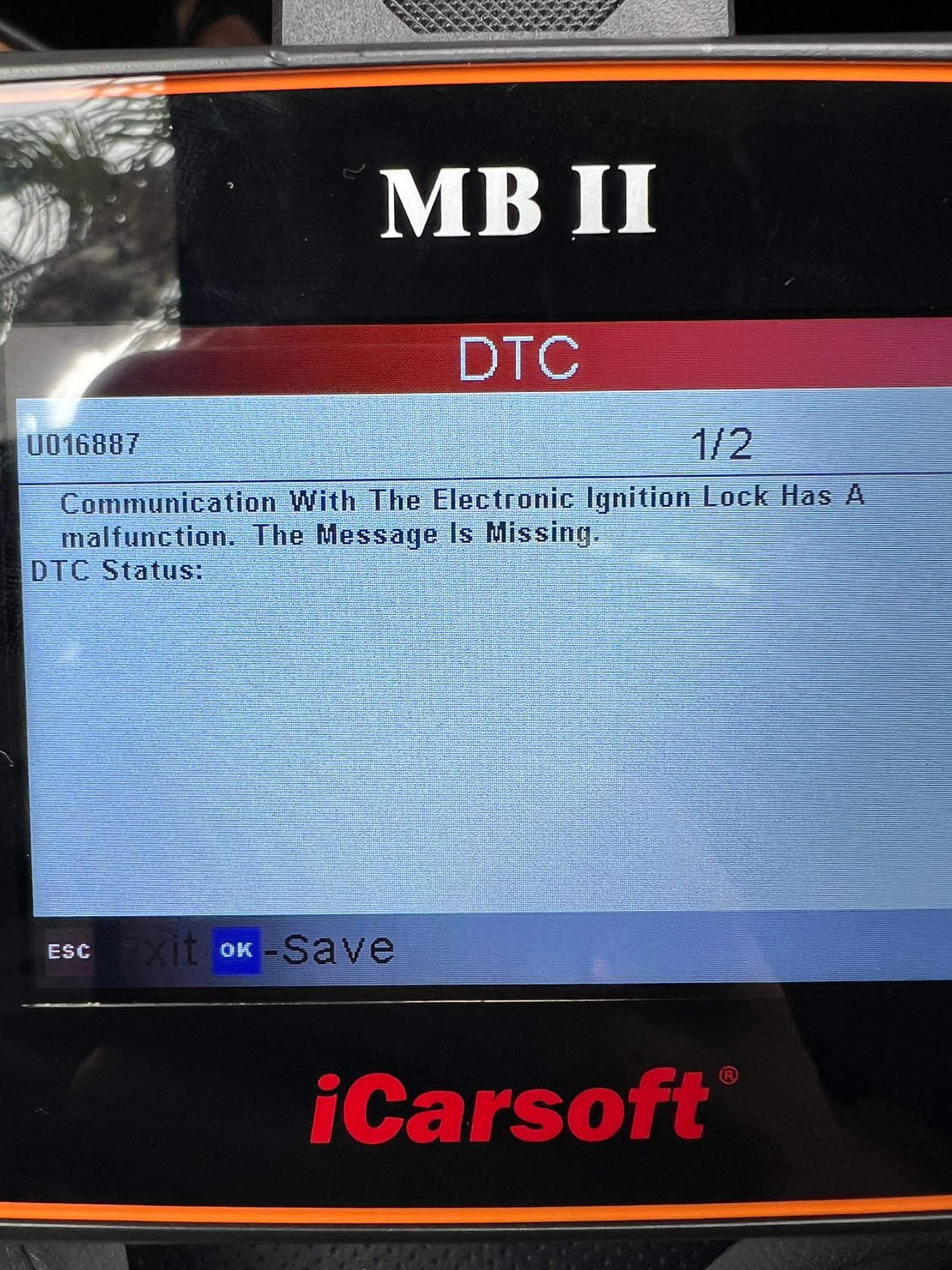

Need help sorting out intermittent start, different scenarios:
1. would not start with push button nor the key , cannot switch gears , total milage not displayed just _ _ _ and flashing.
after disconnecting the battery for few seconds car would start up , no issues for few days
2. not starting - esp message , mileage present , can’t switch gears - disconnect battery and starts right up.
bellow are the codes .
whats the solution ? Ignition lock EIS or ISM ?
all the codes could be erased besides the parking brake .

Mercedes ignition switches wear out - carrying half the worlds keys on your fob is a major risk many fools enjoy gambling on...
won't stop it failing (they made it like that) but it does encourage the issue 30k miles earlier
as with any Merc electrical issue - the real driver might be many little things beginning to behave as designed, as the car ages
