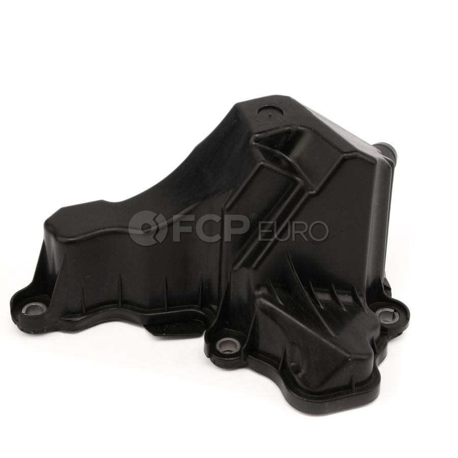

Quick question please. I'm going to go ahead and replace my PCV system as preventative maintenance, but I'm not sure how this oil separator comes off the valve cover. I removed the bolts that hold it in place but I didn't want to FORCE it off if there was something else that needed to be done to remove it. Do I just "tap" it off since it seems to be "stuck" in the valve cover even though all screws are removed??

I replaced or cleaned most of the PCV system last winter. I wasn't sure if this was pointless or not, but the parts were cheap and I figured why not when I was doing a ton of other work. This part came right off for me. Nothing is holding it there other than 3 screws. Tap lightly on the side, or gently pry underneath if it is stuck. But you'll need very little force to get it off.

I am seeking info on how to replace this same PCV valve on my 2013 S550 M278 engine. Do you know where its located and how to replace it? I asked FCP Euro for the part and the one they linked to loos the same as the one you posted here.

Not familiar with the M278 engine but if its anything like the covers on the M272/273 there are no moving parts inside it to wear. Just a bunch of fins that catch the oil vapors.
the cover is on the drivers side head.
Heres the inside of the M272 cover.

I don't even see anything like this on my 2013 M278 so I'm wondering if FCP Euro led me to the wrong part. My interest was replacing the PCV valve on my 2013 s550 as its recommended to replace every 60,000 miles and my car has 100,000 now. There is oil seeping from the valve cover bolt heads on passenger side and the dealership wants $5000 to reseal them but I am wondering if its being caused by a bad PCV valve.

Is this the PCV Valve?

Thats referred to as the full load (wide open throttle) crankcase breather cover which houses the oil drip pan. Its not actually a pan its a centrifuge.
if you reach back and feel/see oil dripping from the cover then replace it.

Im not sure on the M278 but on the M272/273 the bolt for the oil drip pan is reverse thread. Keep that in mind if replacing it.

I just noticed the oil drip pan is the same part# for the M272 and M278.
I had replaced the drip pan and the cover on my m272 as part of preventative maintenance. I had noticed a little bit of oil in the breather hose on the passenger side leading to the throttle body. My concern is the inside of the intake manifold getting all gummed up.
