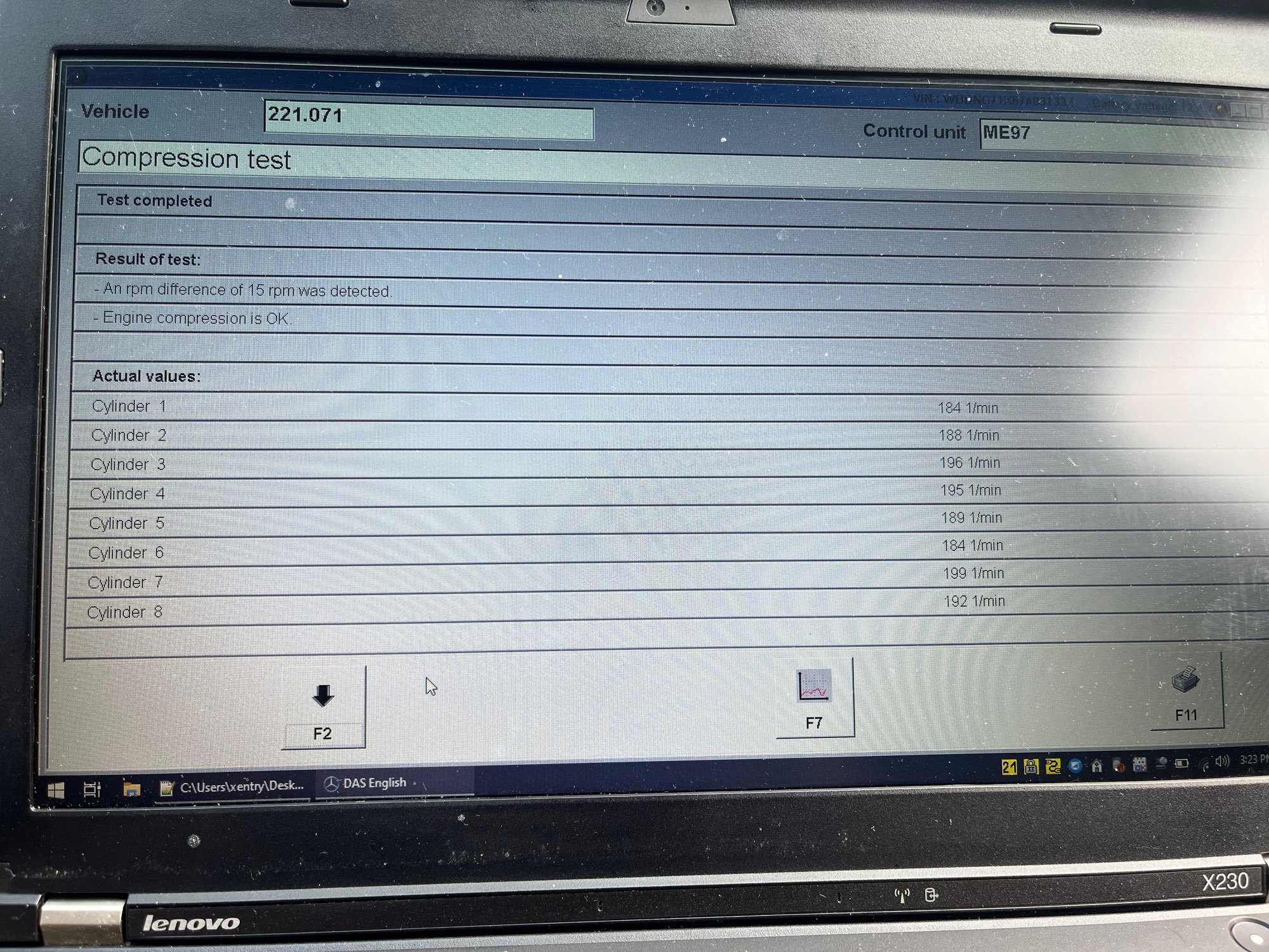

So I I have now changed the spark plug and coil on cylinder 5 and I am still getting a misfire… brand new oem parts…

Leakdown test and compression test.
Fuel injector if the engine is healthy mechanically.
