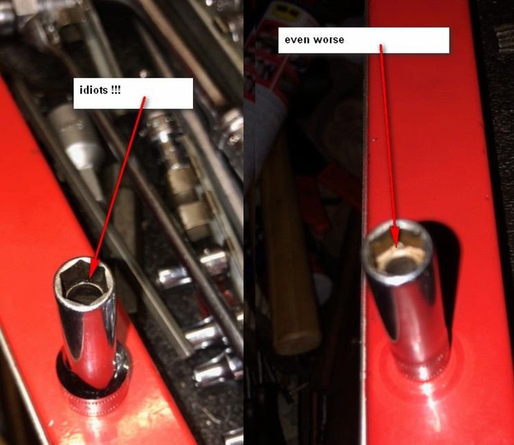

Fortunately within 3 miles of me I have a big multi-brand car place - in stock NGK plug <$20 - packed some tools having checked a video... and toddle round, quick squirt of plusgas to help and then pop on my deep Snap On 8mm 3/8" drive socket - to find it wont go over the electrical bit at the top - looked at the socket and it has a ridge part way in stopping it fitting. Ok that's a pain, get out the deep Snap On 8mm 1/4" drive one I'd brought. Even worse - WTF now what ?
Great I'll have to drive to a tools place and buy some budget junk made by grown ups - that does work. About to jump on the bike, when I went - hang on - didn't that rail of 1/4 drive stuff have some joke brand 5/16" no name rubbish on it - Oh yes - that fits nicely - JOB DONE IN 15 mins (the good news it was #4 one of the easier to reach - glow plug light staying out, fault cleared and went away, jolly good, time for Tea

Glad that’s over.
Pic of the 8mm Snap On that wouldn’t fit?

looks like SM8 and can't read qrt drive one

Agree, makes no sense.

That little ridge is there to keep the nut in place when you're trying to thread it onto a stud or bolt.
Without it, the nut would just go deeper into the socket in some difficult situations.

well of no use if it won't go on the fastening - and who tries to cross thread working like that ???
