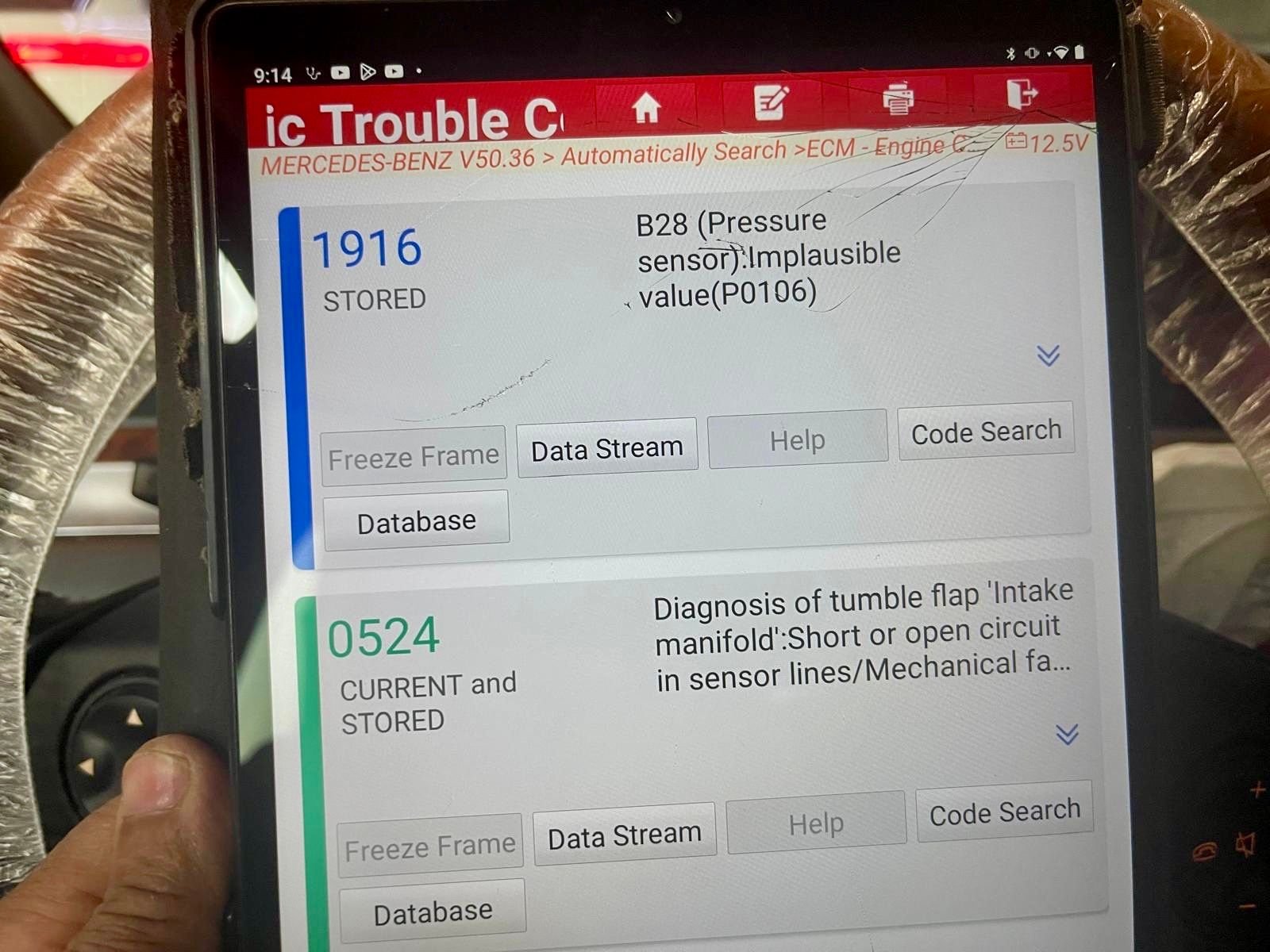

WDD2211711A090086 Engine M273 5.5 L W221 Model 2007
code P0106
what that codes mean? and how i resolve this problem?

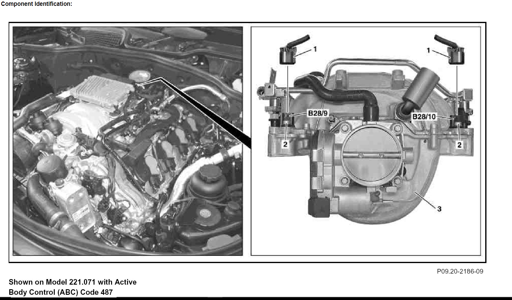

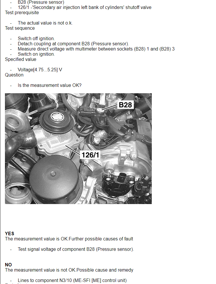

- 1916- Look here: charm.li/Mercedes%20Benz/2007/S%20550%20%28221.171%29%20V8-5.5L%20%28273.961%29/Repair%20and%20Diagnosis/A%20L%20L%20%20Diagnostic%20Trouble%20Codes%20%28% 20DTC%20%29/Testing%20and%20Inspection/Manufacturer%20Code%20Charts/1916/ME9.7/
Looks like the map sensor.

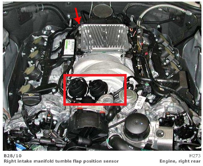

- 0524- This one says current. Could be one of the sensors. May also be a broken lever on one of the tumble flaps. https://charm.li/Mercedes%20Benz/200...0and%20Repair/
Not familair with the M273 though I have the M272. Try inspecting all the linkages on the area in the red square below.

if you check the code 1060 vs plenty of identifiers on the internet - TimC300's already posted about that - its saying info the car is getting from B28 isn't correct in general this MAP sensor should give the engine ECU this info...
The PCM supplies a 5 Volt reference signal to the MAP sensor. Usually the PCM also supplies a ground circuit to the MAP sensor as well. As the manifold pressure changes with load, the MAP sensor input informs the PCM. At idle the voltage should be 1 to 1.5 Volts and approximately 4.5 Volts at Wide Open Throttle (WOT). The PCM looks for any change in manifold pressure to be preceded by a change in engine load in the form of changes in throttle angle, engine speed, or Exhaust Gas Recirculation (EGR) flow. If the PCM doesn't see any of these factors change while detecting a rapid change in MAP value, it will set a P0106.
