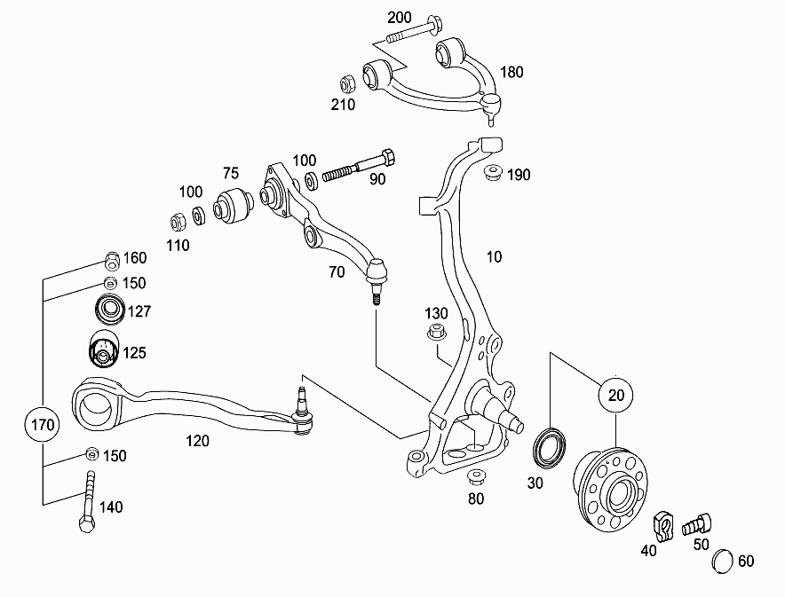

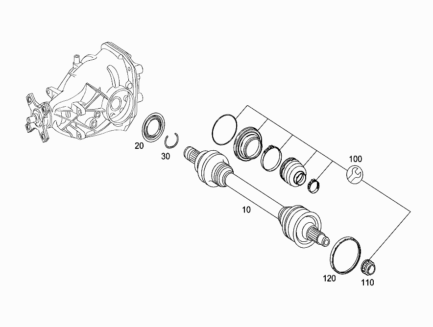

The link you provided for the parts led to a random page for a parts dealer but the part# don’t correspond to any MB genuine part #
If possible can you provide a genuine mb part # for the front abs reluctor rings?
the parts drawing both front and rear are Merc drawings - the numbering 120 (rear) relates to the location on the list of parts for the rear ring - if your dealer is too stupid to put a competent guy at the parts counter, I'm not really in a position to resolve that today....
I also don't have your chassis number to know exactly which model you have - that’s where their systems and competence are meant to come in.... and of course where the parts guy spent more than three minutes serving the actual tech's - he knows how to use the system check old stuff and verify what’s going on by cross ref etc. Don't forget as these are old fossils already 10 year late to their grave, a few parts are deliberately discontinued to ensure Mercedes does its very best to finished them off....
Unless you have a 4 x4 model the front hubs on the rear drive ones all take the very same inner wheel bearing seal - that’s not hard to find
Front wheel bearing seal - part 30 for an early 221 071
030 SEAL RING FRONT WHEEL HUB TO STEERING KNUCKLE A 02 599 716 47 - $7.29 febi bilstein do a competent pattern one
the rear ones - if I go to USA ebay and type W221 MB A2303570182 lots of pattern junk comes up - of course one should expect it to be half as good and likely not fit correctly vs the OEM part https://www.ebay.com/itm/276803140382?
120 IMPULSE RING LEFT Side A 23 035 701 82 - $10.82
120 IMPULSE RING RIGHT Side A 23 035 701 82 - $10.82
