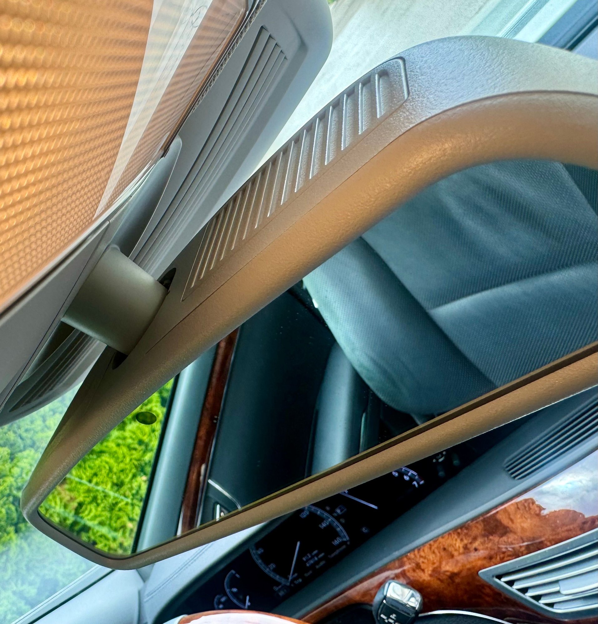

All of a sudden Callers are telling me my voice sounds scratchy on Bluetooth. Any ideas? I deleted connection and tried again and still an issue. Anyone have a pic of where the mic is. Beside the rear view mirror?

I fixed the issue by bowling compressed air above the rearview mirror where the microphone speaker is, it must’ve gotten dirty over the years

here you can see the Grille for the microphone again I fix the issue by blowing some air to clear out the vents
