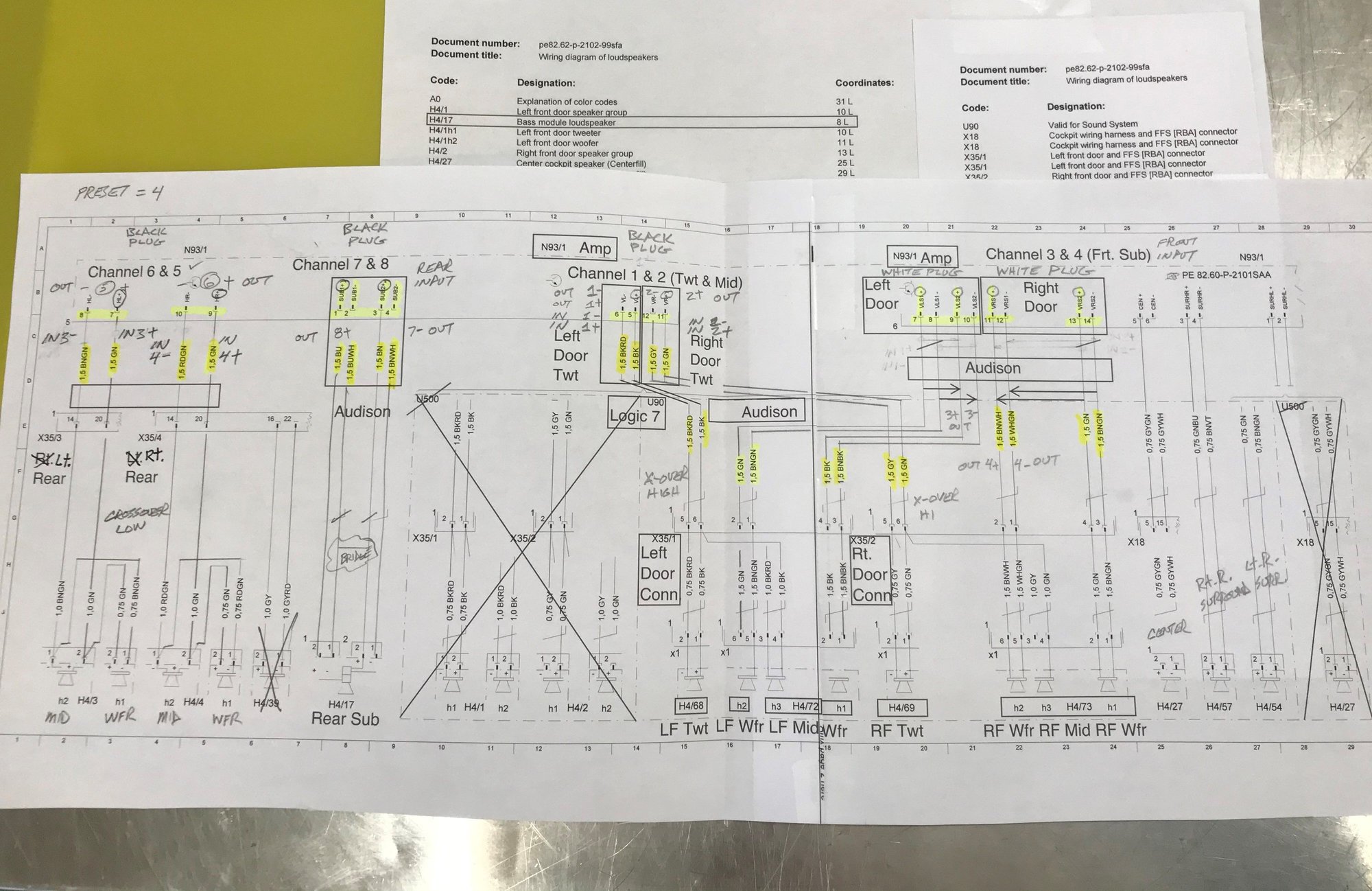

I've been following this thread and I thought you guys might want to see how I approached this upgrade using the 'Mike' Audison DSP.
DSP was mounted in the rear fender pocket by the stock amp.
I cut the wires after the stock amp to the speakers, inserted the DSP speaker wiring, and upgraded some speakers in the doors.
I can reverse everything if needed. It does sound better, and completely tunable. I used both bass outputs to the stock sub.
Don't remember much about the details...right after this install I retired, traveled for 2 years in an RV, and the S550 went into storage.
The S550 is still sounding great, and we drive it daily while on summer travels.
Rewire of speaker output
Cutting in DSP on the speaker wires
DSP mounted next to stock amp
Yellowstone elk
Yellowstone elk
