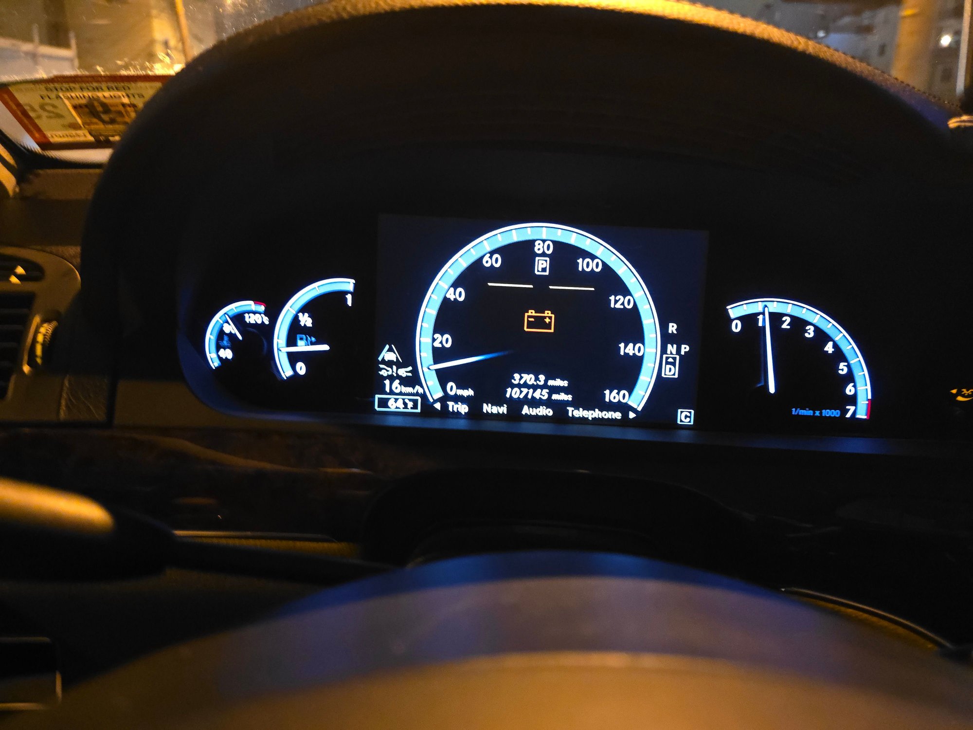

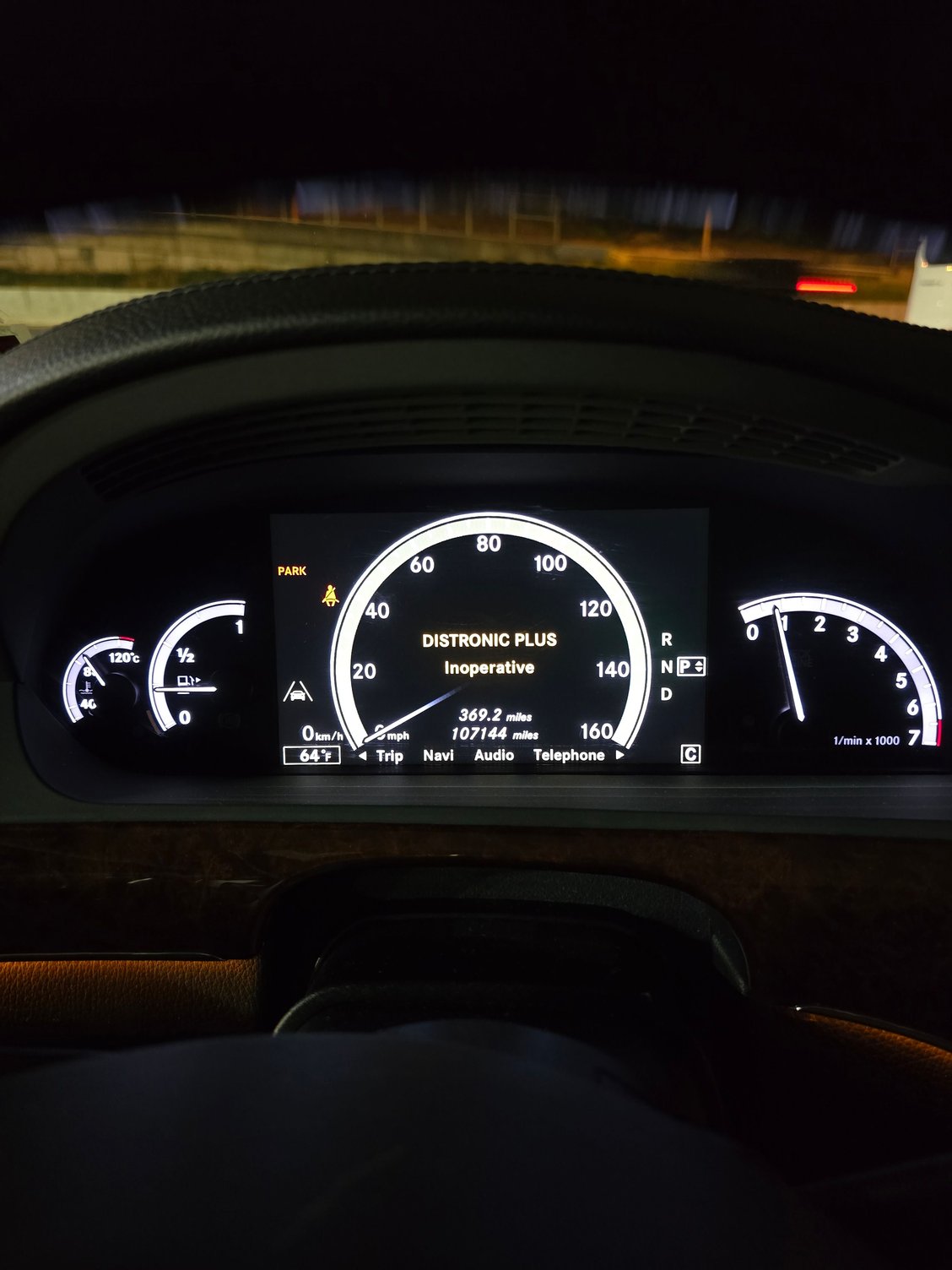

i everyone, new to the group. I have a 2010 Mercedes S550 4 Matic. I bought it at 106347 miles. Before buying it, I took it to two different mechanics to have it checked, and both said the car is in good condition. I drove 1000 miles. The battery light came up. I replaced both the auxiliary and the main battery. Again, the battery light came up. After that, the command center said, while I was driving, "Start the engine, or the command center will shut off in 3 minutes." Then, all the safety features are gone, and the car shuts off, rendering it unable to be driven. Waited for 20 minutes. Jump start. and back to normal. Next day, again the same issue. Did anyone have this problem?
I took it to the mechanic, European car specialist, said, the alternator is the issue. And he talked to the Mercedes dealer service, they said "the car has a special alternator and needs to be ordered from Germany, and the harness must be replaced,too." WTH.
I know I need a 220 amp alternator. But is there any other special alternator thing?
Does anyone have any idea about this?
