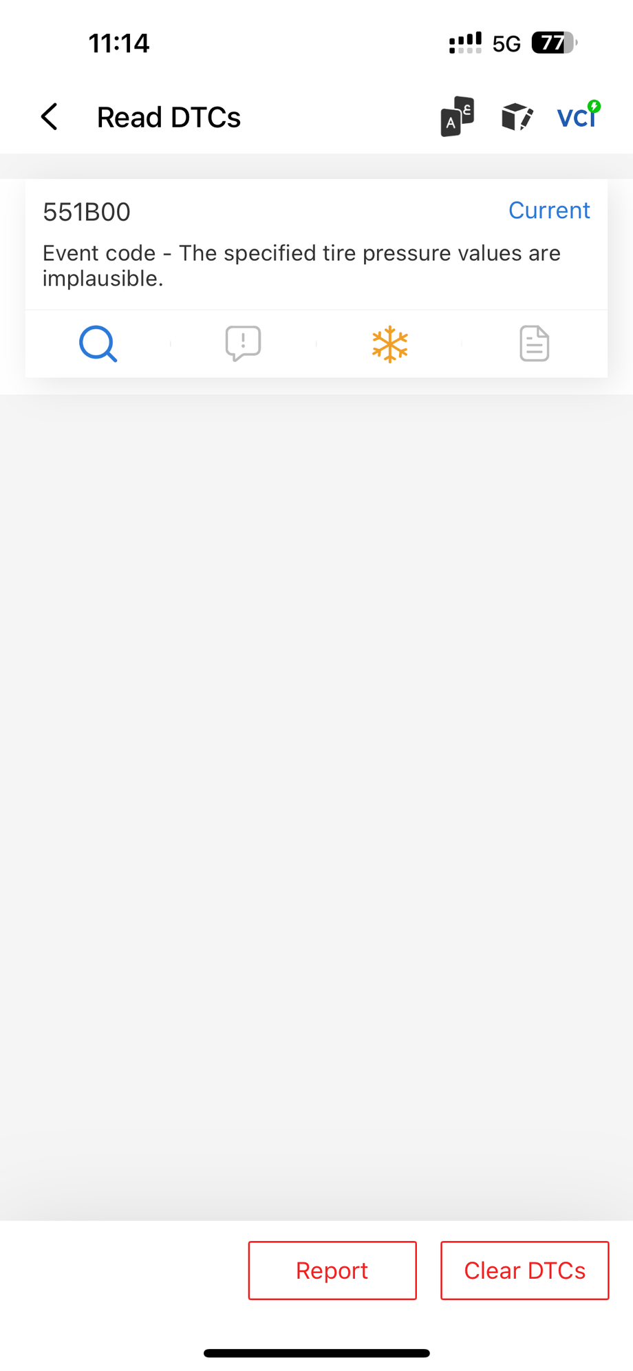

I’m having a light which clears but keeps coming back. I’m getting, “ implausible” My sensors read correctly, when I put my TopDon in the port and read the codes, it shows everything is working but I can’t keep the light from re-illuminating. I’m completely at my wits end. Has anyone experienced a similar issue? My only thought is, the monitor itself possibly defective? I’d buy another TPMS module but I’m understanding, it would it have to be reprogrammed to my VIN? I did replace the one that was reading at 49% but still the light keeps illuminating. Anyone have any thoughts?

What are the relevant DTC's?

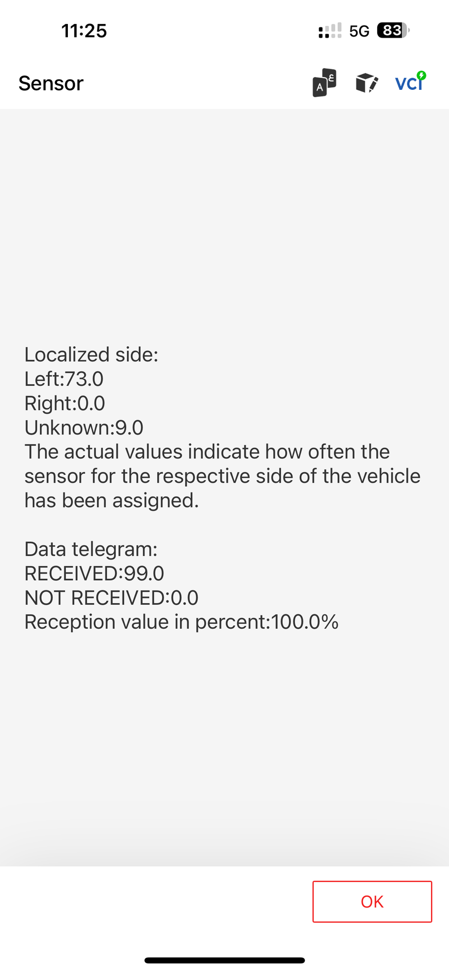

This is what it said but now all my tires have the exact air pressure and yet the light pops back on.  All reading at 100% and receiving and transmitting signals with no unknown signals.  I replaced the front RH sensor, which brought everything inline with each other
