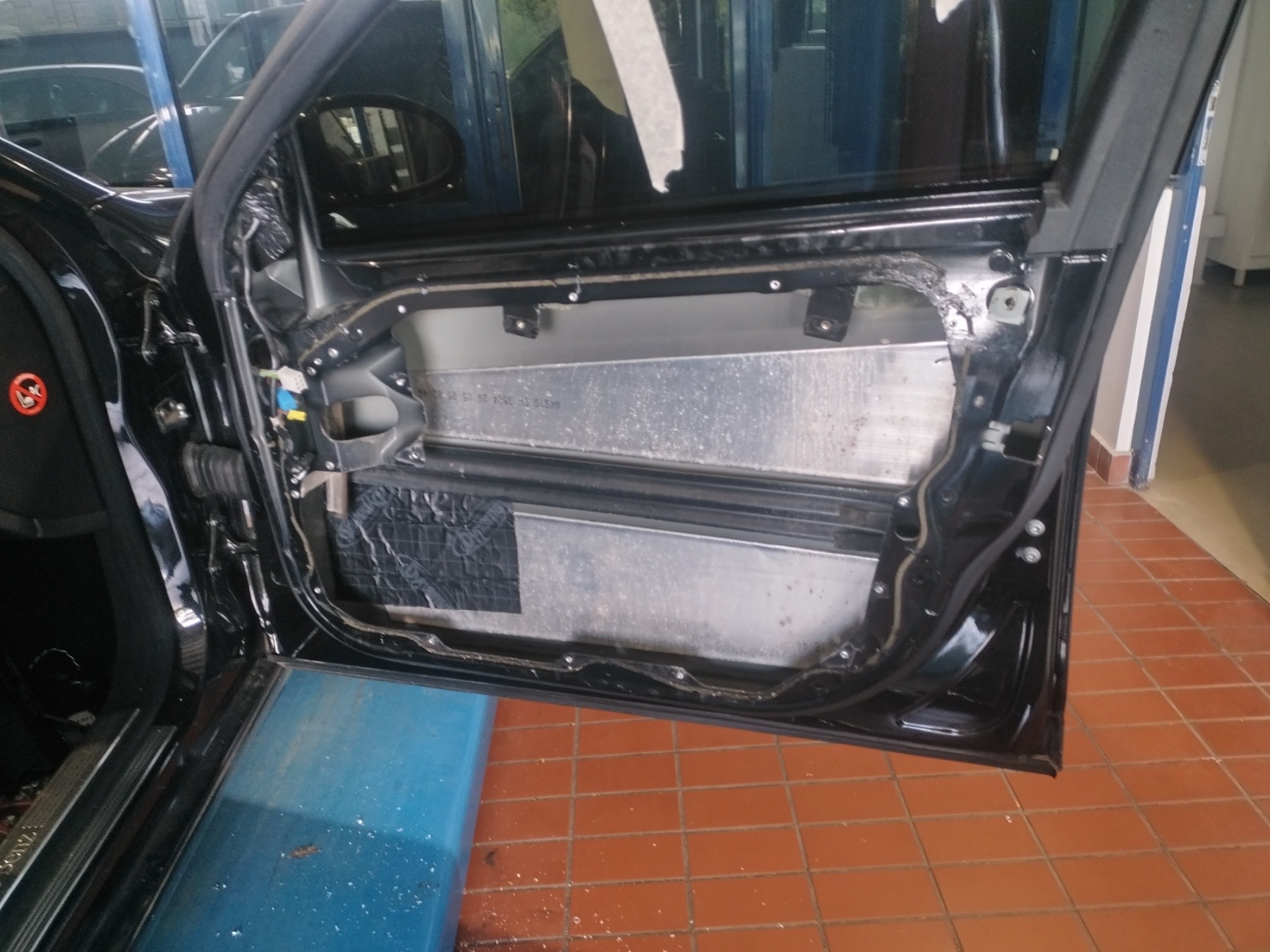

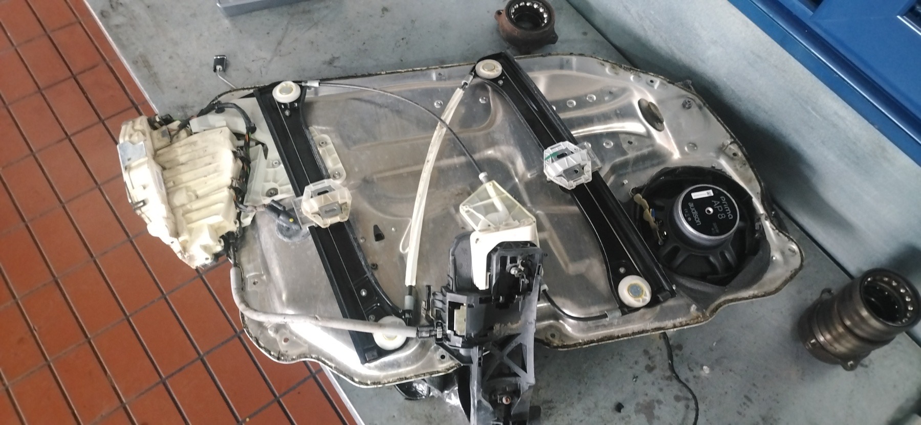

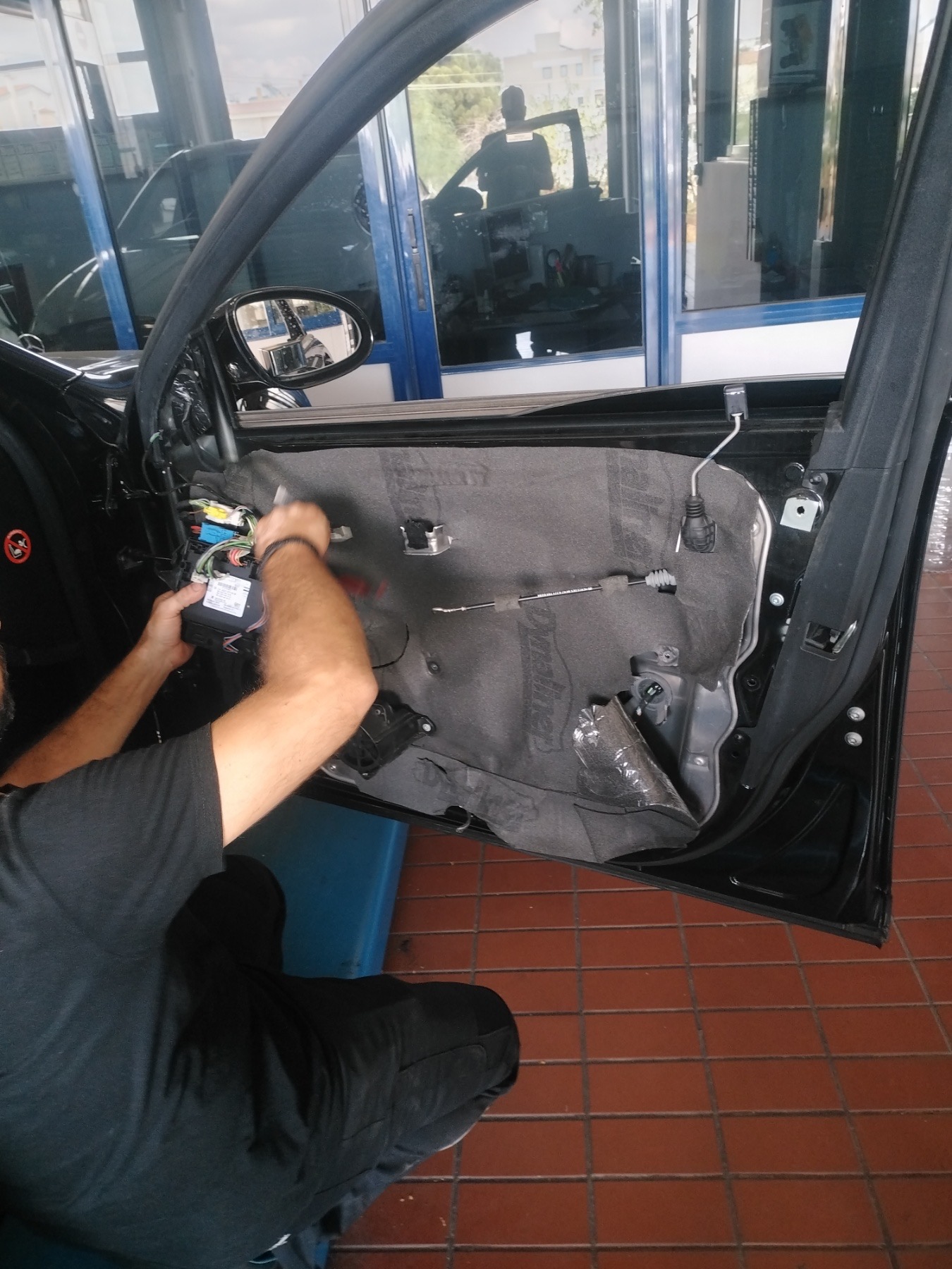

Soft close door latch mechanism failure
It seems like right after I finished my Audison project, not only I, but many people in this forum acquired a variety of problems.
We are still dealing with the ABS/ESP situation, and ontop of that we have a new situation now, the passenger front door latch "soft close" doesn't work, and comes back with an error about microswitch stuck.
Basically the door closes, but the soft-pull doesn't work anymore, you have to hit the door rather firmly to close it.
(This is one of those times that having a simple car i.e. W221 S280 w/o any of this stuff sounds good)
Tried to buy a new door latch mechanism from the dealer new, however it's no longer being sold.
Bought a used one, which was subsequently installed by the dealer, it worked for about 10 minutes, then got stuck.
Now, buying a "OEM new" (basically what I consider a copy mechanism) for 450 EUR and we'll install it tomorrow and see what happens.
All of this started quite violently, and I notice also that a lot of people in the 221 forum have problems as well that just literally popped up out of nowhere.
I hope this bad season goes away fast for all of us.
I don't mind fixing things, but I don't like these annoying problems, i.e. the other friend here with the fuel pump etc, these things are unpleasant.
All the best & fast repairs/recovery to the team!
