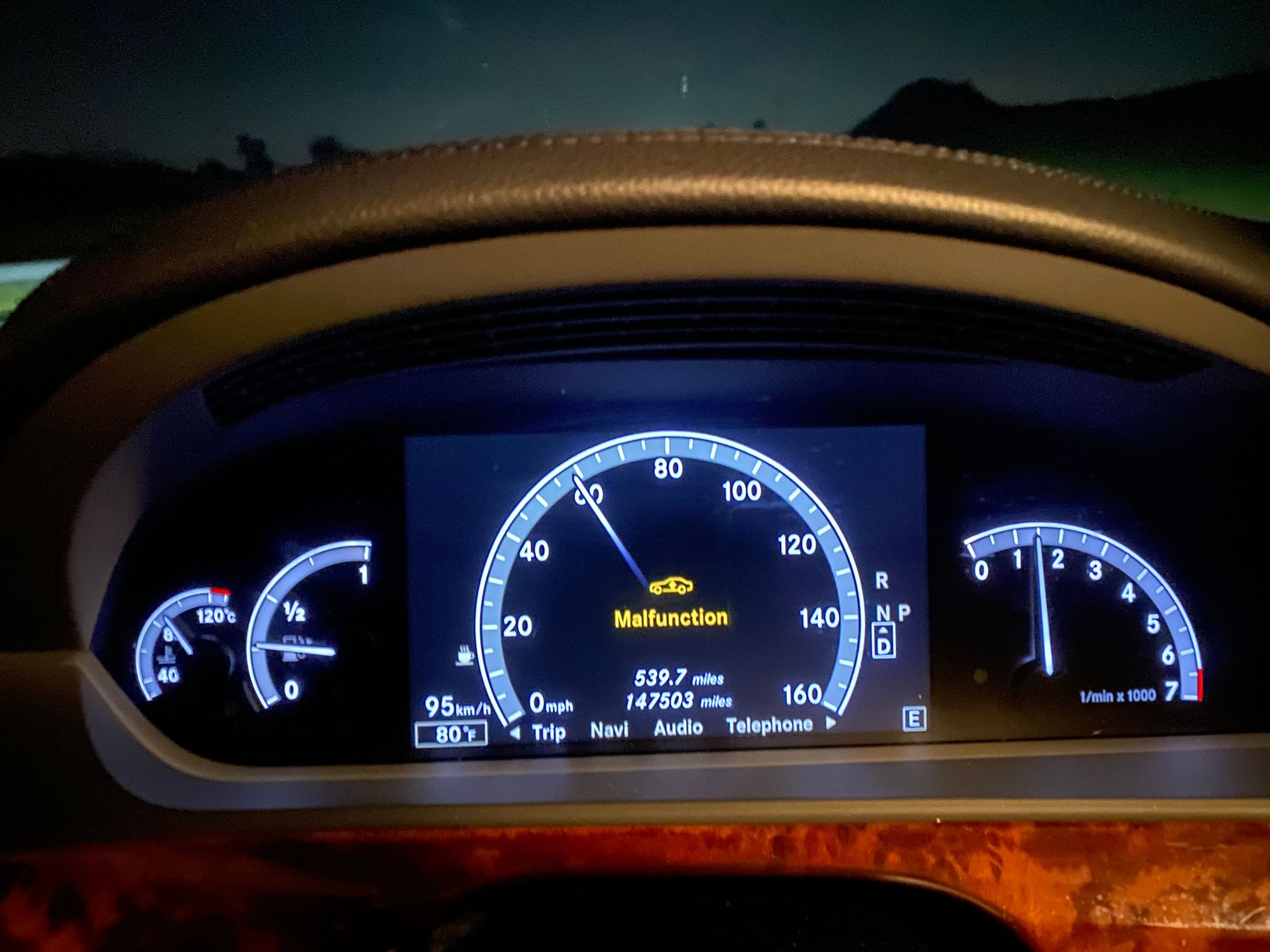

Hi Everyone, few months ago on my 2011 Mercedes S550 Base model this message "Malfuntion" started showing up on the dash. In the beginning message will show up after I drive the car for 10-15 mins, however later it started showing up few mins after car was started.

Up until this point I didn't really looked into this myself so after $9000 sticker shock I decided to do some minor troubleshooting of my own. Pop the hood and immediately realize that "Air Compressor" seems to be working overtime. Also car was not rising up or down as expected when "Air Compressor" is on. Fired up YouTube and this is what fixed my issue:
Replace:
1. Air Valve Block - OEM PN: 2123200358; Purchase Aftermarket from FCP Euro: SKU: RAP-LF22 $190.99
2. Air Compressor - OEM PN: 2213201704: Purchase Aftermarket from Autozone: SKU: Arnott PN: P-3246 $356 --> This came with relay, however I decided to get OEM from Dealership. #3 below
3. Air Compressor Relay Switch: OEM PH: 0009928523: $35.68
4. Air Compressor Filter: OEM PH: 2123200169: $25 --> Purchased from Mercedes Dealership.
2 weeks have passed since the above parts were replaced. "Malfunction" message disappear and Airmatic System working as expected. Car will eventually need Front Right and Rear Airmatic struts replacement. will fight that battle when time comes.
Hope this post will help someone facing the similar issue.
