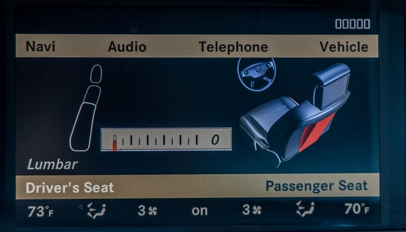

I have a 2007 S550 that I purchased a while back from a friend. While going through its options I learned that it came featured with Multicontour/Dynamic Seats with the massaging feature. When I clicked the button on the center console to open that menu to adjust the seats, I was presented with something that looks as the video shown below (not exactly me or my car but the problem and situation is the exact same)
First thing I need to mention is that I am not a professional and all though I may attach some things, a lot of what I may send below may not directly coorelate with the problem I have.
It shows the option "lumbar" with a slider that does nothing (although mine doesn't reset back down to zero).
It is missing all of the other adjustments such as sides, shoulders, etc and is also missing the massage options such as "fast and rigorous", "slow and gentle" and whatnot.
I should say that just like in the video, I believe my car was programmed/modded to include the aux in feature as I have a bluetooth receiver to use it wirelessly with my phone. But as said in the video, it shouldn't affect the seats in any way.
My pneumatic pump works, because the vacuuming on the door still works great, and it is both the drivers and passenger seat that do not have ANY features whatsoever.
The car was in a front-left accident, which was around where the CGW was that I will get into my theory.

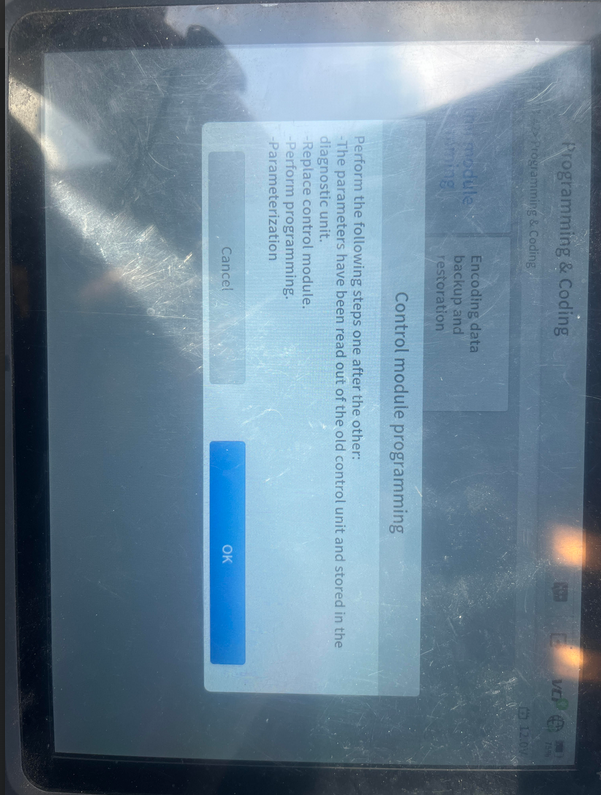

Using an XTool code reader the scanner has "no communication" with the front left/right mulicontour seat modules
There are no codes for anything to do with this.
Attempting reprogramming of any modules in the car using the XTool code reader (which pulls software from its own database that it gets from the VO (from CGW) of the car) returns me a message in the image shown below
My guess as to what this means is
"We don't have any software in our database for your VO"
Which could be for a couple reasons such as:
We never had any 2007 S550's in our database
or We never had your specific VO in our database (because of the bizarre situation)
My theory is that when this car got in a front left accident (where the CGW is) the module got damaged, and was replaced by another CGW that didn't have the Multicontour/Massage options programmed into it.
This is just a guess and I am not that educated to know for sure but its my idea. Is this theory plausible? If not what is likely going on? And what is the solution?
If my theory is correct I should take to it an electrical shop that I know, and ask for multicontour to be programmed into the CGW and to reprogram the seat modules.
Old Sep 1, 2025 | 08:47 PM
Alexie's Avatar
Joined: Jun 2025
Posts: 784
Likes: 249
From: USA
Your theory is spot on. A replaced CGW (Central Gateway) without the correct coding for your options is the most likely cause. It's the car's communication hub, and if it doesn't have the seat modules listed in its vehicle order (VO), they will be inactive and invisible to the diagnostic system.
The solution is to have a specialist with Mercedes-specific software (like DAS/Xentry) code the multicontour seat and massage options into the CGW's VO. This should wake up the seat modules and restore all functions. Your local electrical shop will need the right tools to perform this Mercedes-specific coding.
