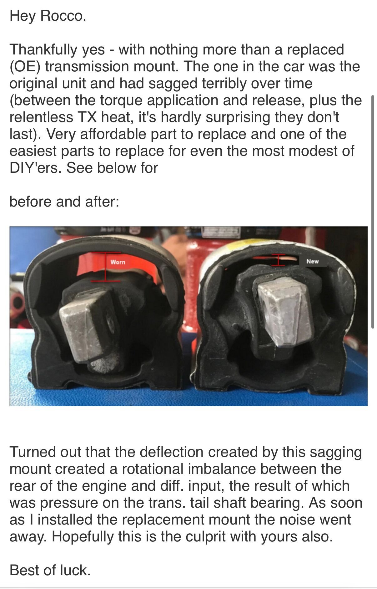

I also inquired with a member here who was describing the same exact issue with his same model, I’ve attached a screenshot of his response.
Would be amazing if a trans mount resolves the issue, but the only difference in his description was “the sound is NOT replicated in neutral”.
If not the A/C recharge and trans mount, it does sound & seem like it could be the trans oil pump.

its not the trans mount - its the centre bearing on the prop shaft its made of chocolate - its rubber mount collapses - it also wears two bushes that are pressed into the ends of the prop shaft
NOTE The prop shaft is the correct name for what Americans ridiculously call a drive shaft
drive shafts are connected to the wheels - and is basically the independent equiv of a half shaft on a beam axel - whereas a prop shaft has only ever connected the gearbox to the diff (on a car)
either way this doesn't produce a whine... it makes the car shake like its got massive road wheel imbalance and often goes away with 20 mins warming up the rubbers donuts

This is exactly what I was thinking, but his description of the whine in his post sounded very similar to what I’m experiencing. But I thought that was odd also.
