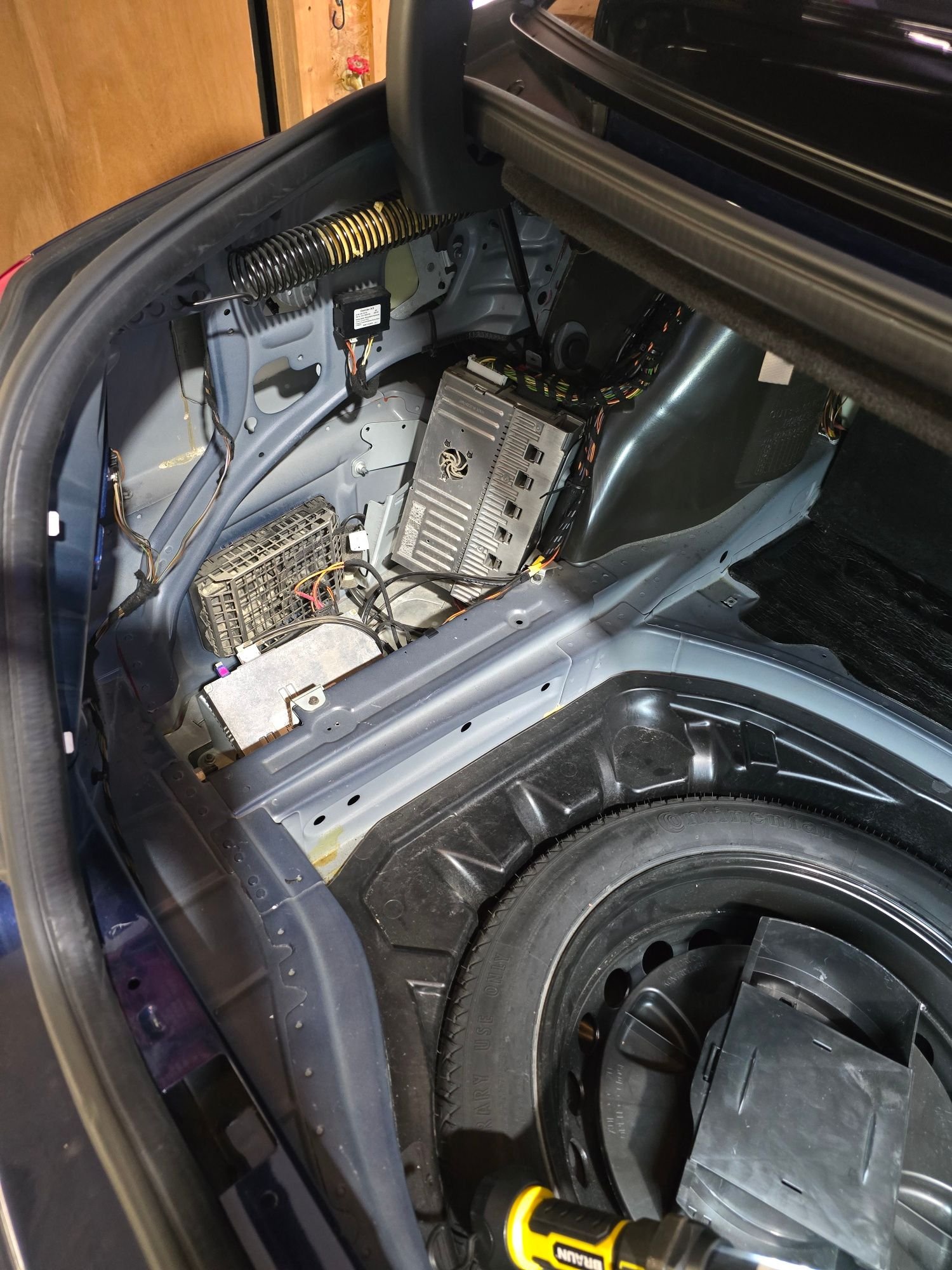

My brother is having probs with ALL 3 of his MB's This S is his somewhat daily driver and the radio has stopped working.... I think it might be a communication error/optical cable issue....
Any ideas or suggestions? TIA

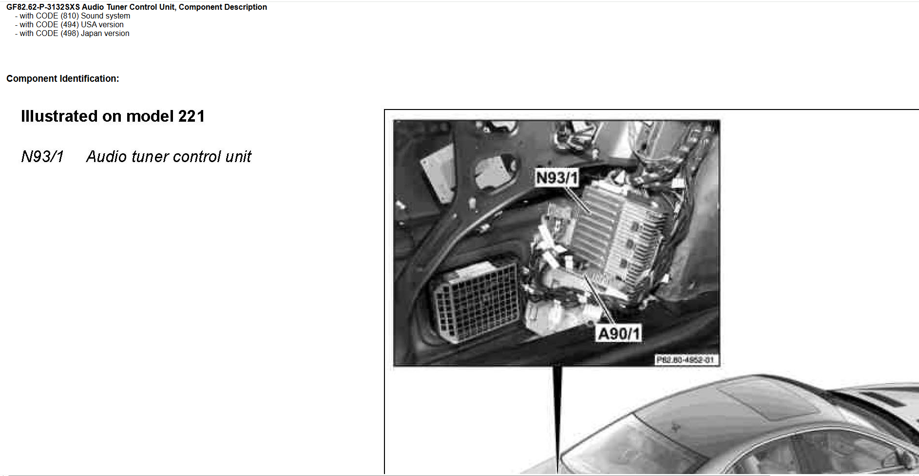

the Amp/Tuner combined module in the boot gives up - highly likely a re-flow issues with a chip set overheating and unsoldering itself from the circuit board - but most repairs don't last
if everything on the system operates normally but the sound vanishes - the Amp is dead - and sadly its stupid money - if you try secondhand aware nearly all are dead or about to die. Always check on FM tuner
the other common issues is the Sirius tuner dies (another module gives up) and it breaks the MOST circuit.

Thanks for the help, he pulled it out of the car and is gonna open it up and take a look and see if there is any obvious signs of damage/overheating... said if was VERY dusty and you can see there is a lot of dust on the exhaust vent on both the unit and the vent behind it....

again that's normal - exhaust, road filth fumes and 15 years of dust in the area - the egg crate on the inner wing is a massive hole designed to let flood water in to kill the car
you can clean the board till it looks like new and you won't see any area that causes the issue - they designed the failure with their usual precision
