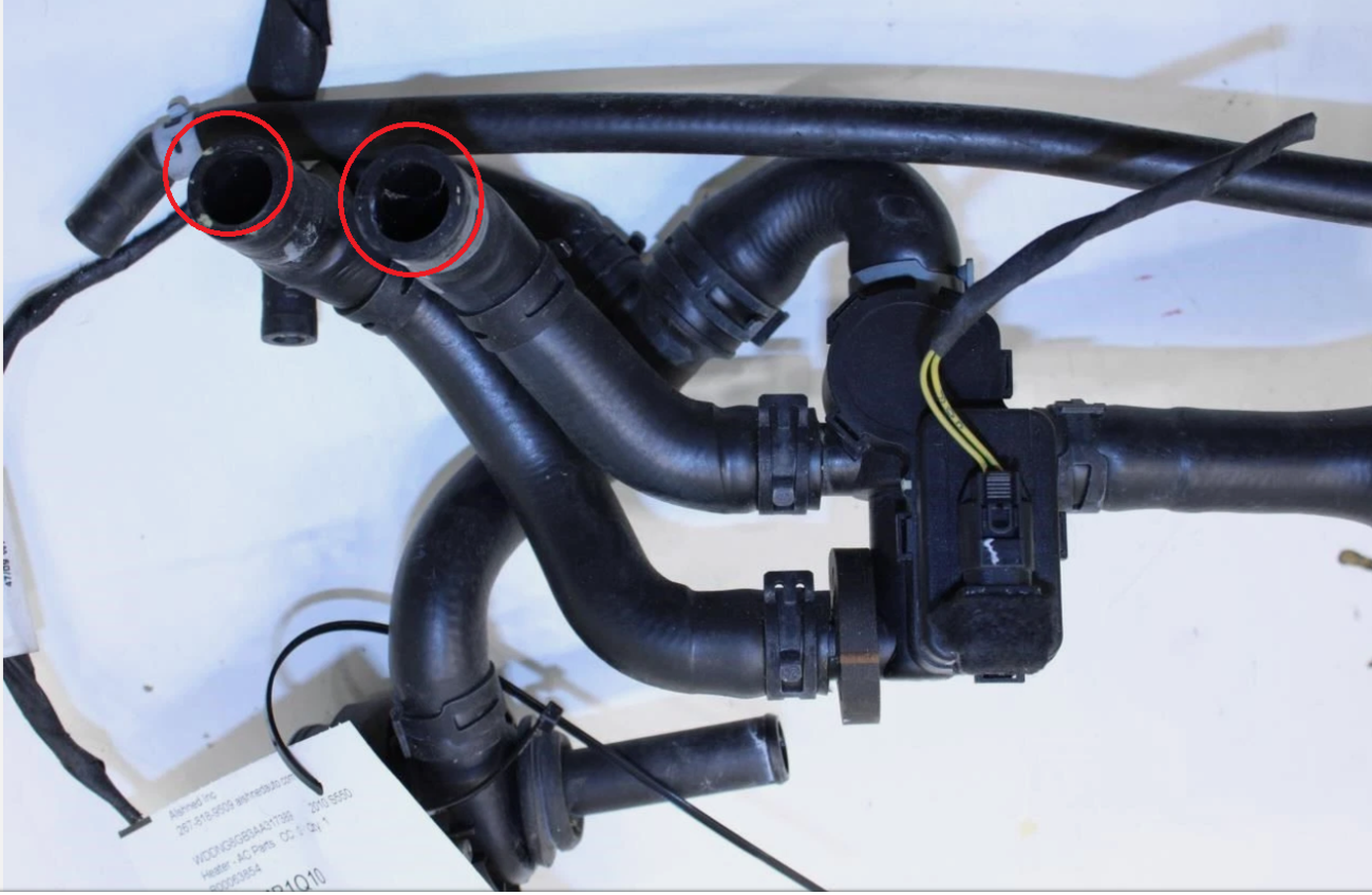

To ensure proper installation, could you please confirm that I have correctly connected the hoses to the respective ports on the heater valve? The correct configuration should have port #1 connected to the left metal pipe and port #2 connected to the right metal pipe, which is attached to the heater core, when facing the front of the car, is that correct? No sure this makes a diff

Those hoses are less than a year old, which wouldn't explain the lack of cabin heat. Notably, both hoses are steaming hot when the car is warmed up.
Originally Posted by BOTUS
both hoses have had it - the left is about to pop

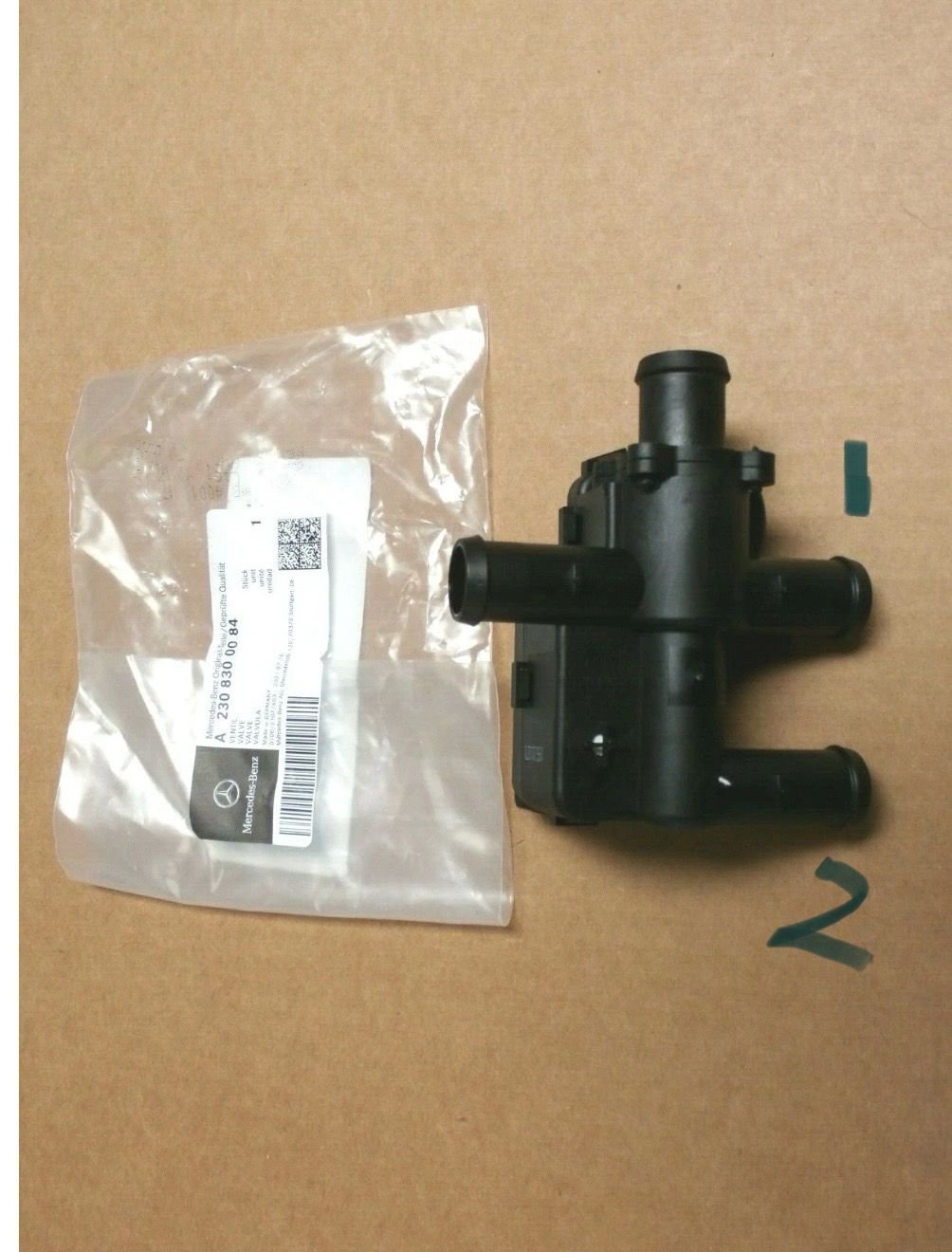

According to the diagram and photo the two hoses have different part #'s and should be shaped slightly different. Can see which hose does to each port.
1 towards passenger side. 2 towards drivers side.

I changed all these hoses and valves last year. The photo posted above syncs up easily with how everything should be oriented...you really can't mess it up if your car's setup looks like the photo. I have a Graf waterpump bought from FCP Euro, and it works fine. I wouldn't buy a Uro anything though--that might be something you should replace with a better brand.

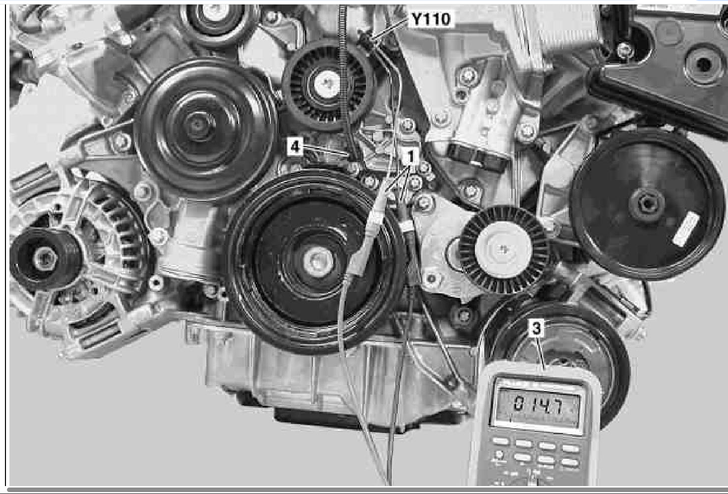

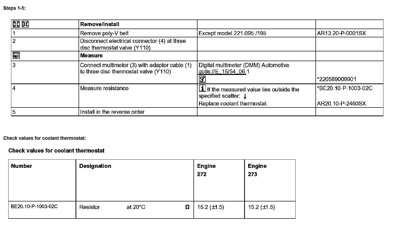

Can test the heating element using a multimeter. Says just measure the resistance.

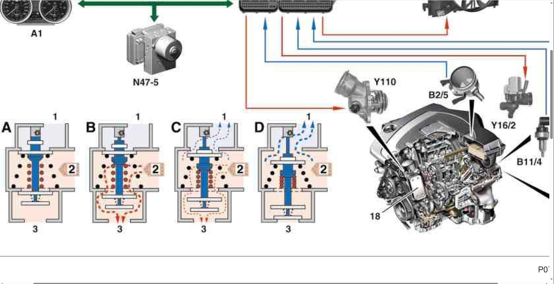

I dug around for how it works in the car GF07.61-P-4016VB below.

could it be that "strange" odd top hose connects in different ways ?
I was quite surprised to see the info Tim provided above, about how the thermostat operates with three independent modes based or temp vehicle use ?
could it be there was an old world other way to do stuff with coolant routes and or a thermostat that goes with odd hose and its metal elbow ?
or maybe the engine ECU and all the heater control must be on the same compatible software ? is the engine management on the last 2008 iteration - or was it chipped and they tweaked some stuff wrongly ? there's a whole world of insanity inside the engine ECU re coding

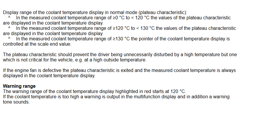

I was driving the other day and was paying attention to the coolant temp. From a cold start it took around 8 minutes for the temp gauge to get up to where it stays normally, for my M272 thats around 85 c. It was around 53 f outside and I drive normal rpm's 1,500-2,000.
But then also consider the temp gauge is not showing the actual coolant temp. Basically when the coolant temp is 80-110 the gauge will show around 90 constantly.
