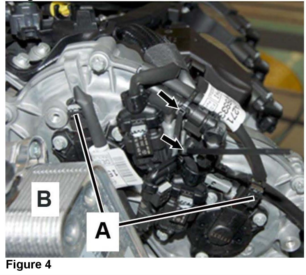

I would remove the top front cover and inspect the area around the cam sensors & adjusters. Do you have the additional wire harnesses on the cam adjusters? (figure 4 below)
My M272 engine has 160,000 miles. I had one small oil leak on the passenger side which was solved by replacing one of the cam sensors o-rings.
Without additional harnesses installed:
With harnesses installed:
