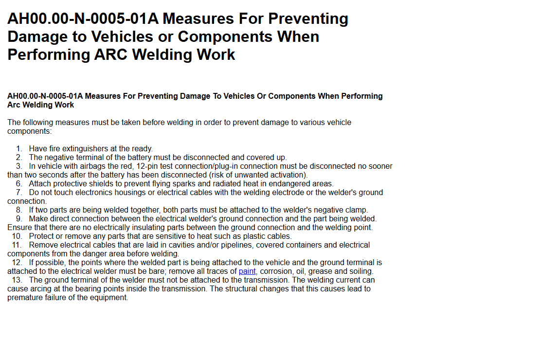

Hi, I was going to remove the resonators on my '13 S550 for a bit more sound. For those of you who have done it, are you just disconnecting the batteries when welding or dropping exhaust to weld? I only ask due to finicky electronics. I don't want to screw anything up while welding...

So when you welded on your exhaust, off or on the car? Just trying to figure out how it effects the electronics on these cars. I always do it on. Just seeing if it triggers any issues.

batteries Off always safer - silly one under the dash too
electrics should be OK - just reset the windows and sunroof re anti trap afterwards
