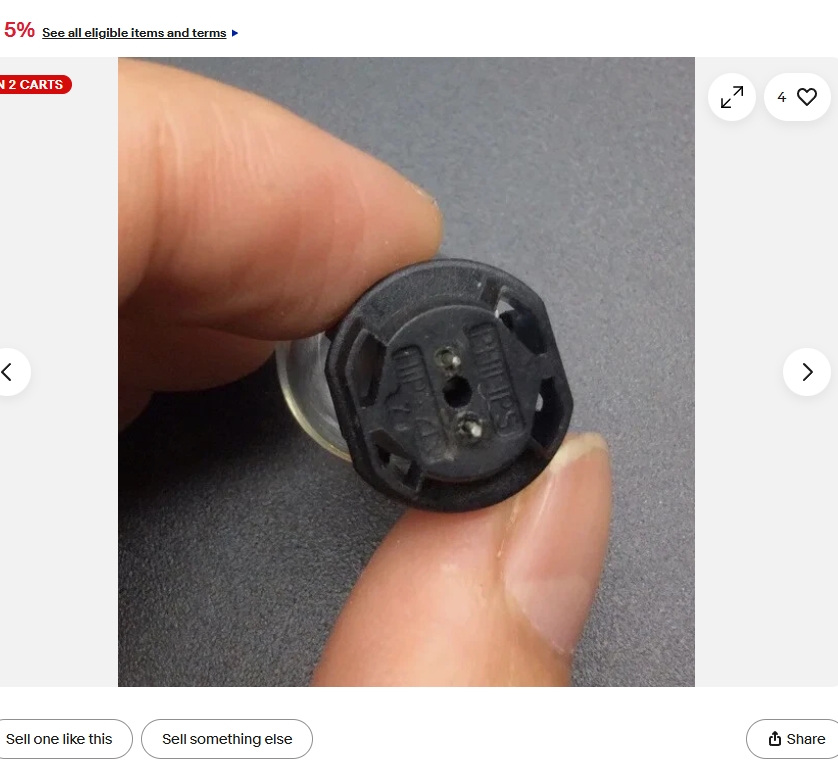

I dont have a 221 so cant check. I looked up the 2008 S-Class operators manual to see what they say about bulb replacement. Looks like the reverse is a "HiP 16w". I never heard of it before. Found some bulbs on ebay that seem to match the bulb carrier posted above.
Im assuming 13 is the backup lamp.

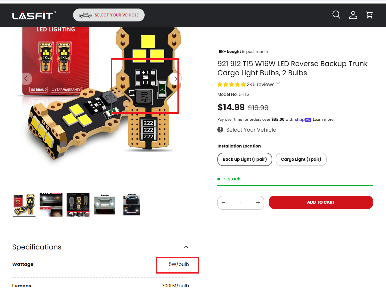

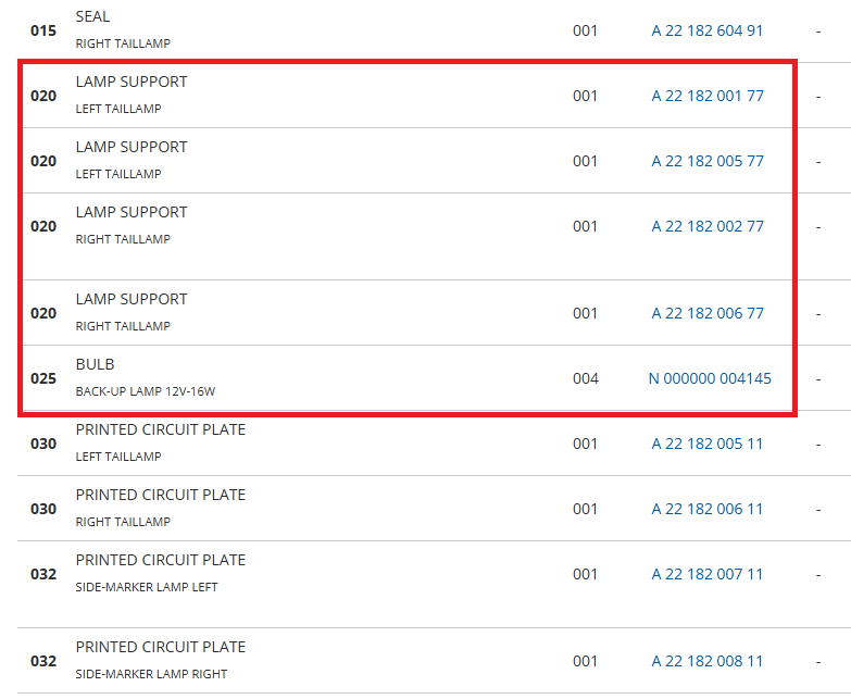

Would be nice to see a photo of the bulb carrier that is in that car.
I looked up the 2010 S550 Operators manual and it mentions the HiP bulbs. Then I looked thru the 221.171 parts diagrams and it shows two different bulb carriers that can be installed. One of the carriers does list a W16W / 921 bulb.
My knowledge with electronics is limited especially with understanding can-bus. Easy thing to do is just search on Amazon for 921 led bulbs and check out the specs of the bulbs, see how many watts each bulb is rated for. Other than finding replacement bulbs with the same watts I wouldnt know what would work or not as far as getting bulb warnings.

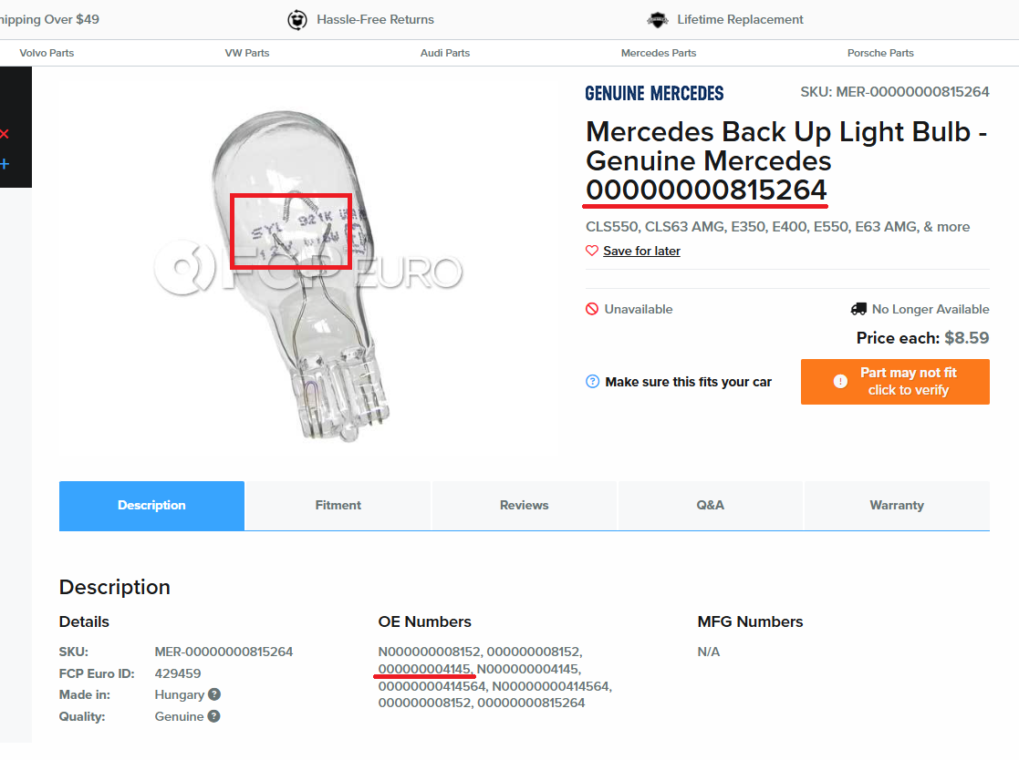

Looking at the actual bulb, the part that is clipped to the cluster is actually a bulb holder.
If you want to really upset the car, as per the OPs first post, buy the cheapest, crappiest.Chinesium tat LED from Amazon or, better yet, TEMU, jam it in an wonder why it doesn't work properly... 🤦
Old Mar 27, 2026 | 02:54 PM
AL5461's Avatar
Joined: Oct 2023
Posts: 606
Likes: 208
W221 S500
Looking at the actual bulb... N000000 004145, the black holder should be reusable.
Forcing a traditional bayonet type bulb into the cluster is only going to end in tears.

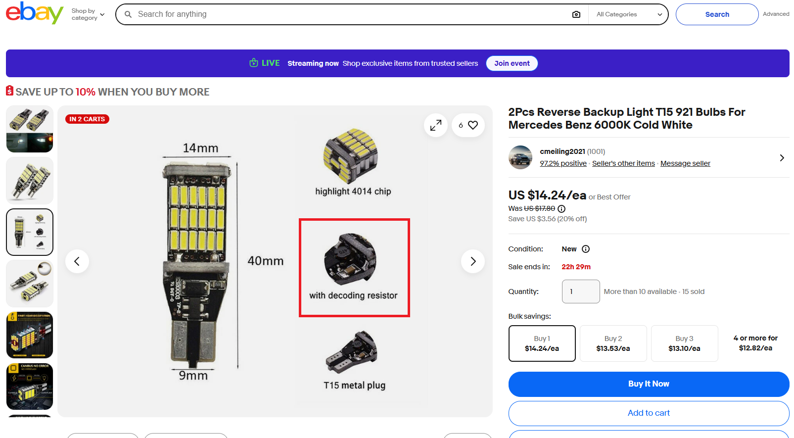

My car is a facelift, people say led bulbs will work as long as they have resistors buil in them
Old Mar 29, 2026 | 12:32 AM
dakare46's Avatar
Joined: Dec 2006
Posts: 162
https://sealight-led.com/product/sea...YaAjLcEALw_wcB
they say these will work, i have to try it, refund available
