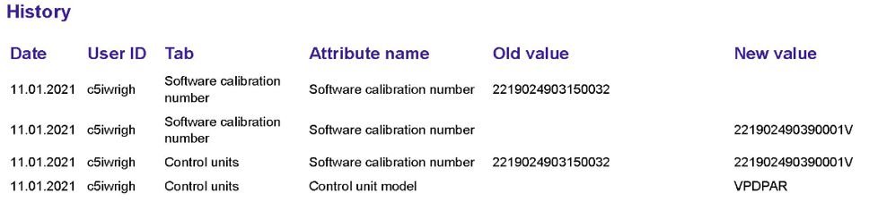

there is a way to pull all the software updates a car had with the specific detail of when and which garage applied it
this is where Merc redid coding for the Rear SAM correcting SCN 12 years after they release the software !!! to make the error for the rear sun blind disappear
