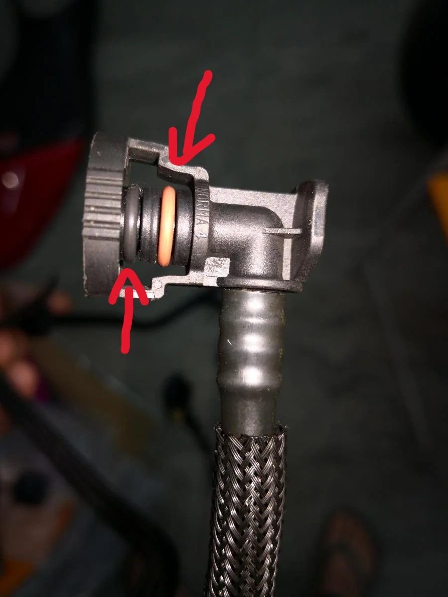

So I was replacing the fuel filter the other day on a 2010 W221. When I reinserted the quick connect lines to the new fuel filter, the o-rings that were on the quick connect broke apart. Anyone knows how I could get this exact o-ring and replace the broken ones? Due to this I noticed that the fuel line wasn't able to hold pressure, so it always takes awhile to start up everytime I turn off the car and let it sit for awhile. I have attached a similar looking quick connect to the one I have and marked out the o-rings that I am talking about.

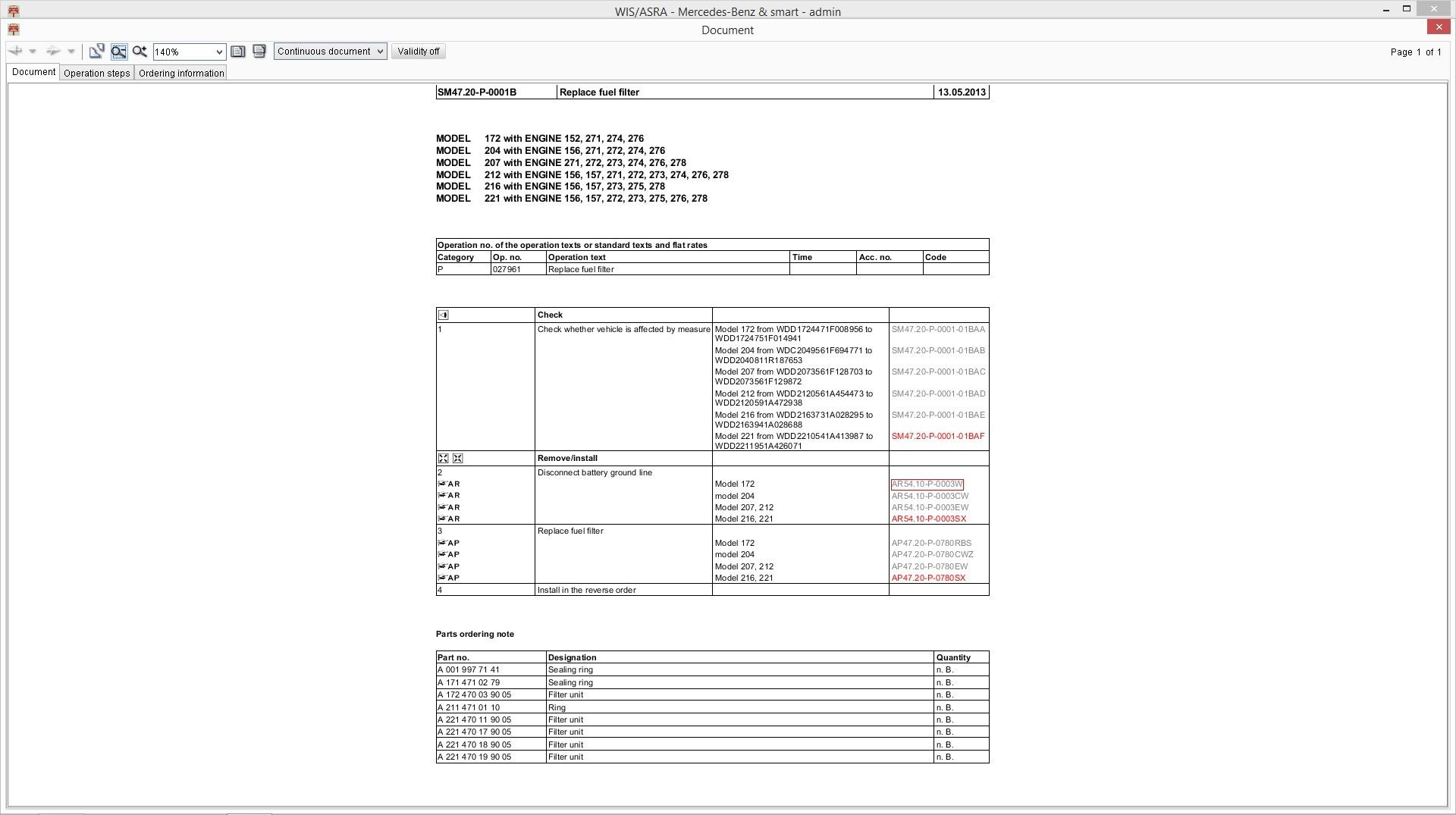

Disregard my previous attempt to be funny. I pulled this just now from WIS. Have fun.

Well it looks like that didn't work either. I checked those numbers and they are filter housing seals, not fuel hose seals.
I found this part number for the connector seals, however.
A0179972248

O-rings come in standard sizes. Take them to an auto store and see if they can match them.
