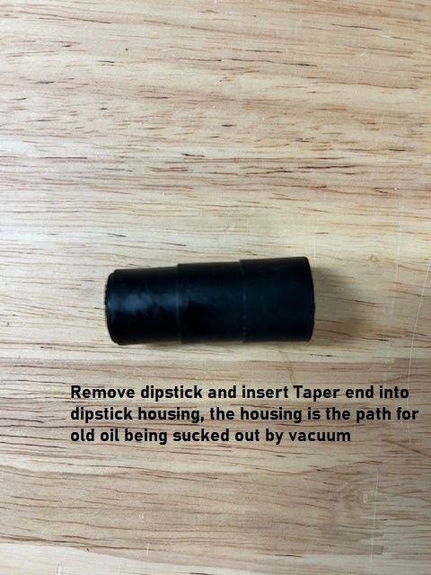

***Before anyone asks about the pictures, I'll attach them once I leave the office detailing the entire process. ****
ENJOY and I hope this helps everyone.
Let me begin by saying how awesome and effortless this process is if you own an extractor. The entire process from start to finish was 34 minutes including setup , extraction , filter change and adding fluids. There's a couple of advance items to check off before beginning. I spent a few hours researching some of the customer comments, Positive and negative about the 7201 extractor. I applied their recommendations and it made for a flawless process. Hopefully, this will save the next person some time and make the process even easier.
Before you begin:
1. Check the oil level- I found surprisingly that I needed 1/2 quart to a full quart of Oil. Now this was my normal A service at 47K miles. I read in the maintenance manual that the S class can burn up to .08 quarts of Oil per 600 miles. Needless to say, you should be checking your oil frequently irregardless of your dealer visits. It' s just a good practice to keep your oil filled. This also gave me a good indication of how much oil will be extracted .
2. Run the engine just at or below normal operating temperature before extracting the oil. It helps the process move along better when extracting. Be careful to consider the tubing temperature allowance. Don't drive your car all day then put a PVC plastic tube down your dipstick without considering if the temperature is to hot for the PVC tube. There's been stories of people melting the tube or chucks flaking off because the engine is just too hot. This is just plain common sense .
3. Measure your dip stick and added 3-6 inches extra length to the tube that will be inserted in the dip stick hole. My 2014 w222 used the 1/4 PVC tubing size. My extract came with 3 sizes and the 1/4 was the only one that fit. Connect to a larger tube going into your extractor no more than 6 inch above the dipstick hole. You want the gravity and pressure to help you with the car being higher than the extractor and without any loops or ups and downs in the total tube length.
Let me reinforce the need to test fit your tube in the dip stick to find the bottom without forcing or curling. I found my length after 2 or 3 tries. Once you have it, mark, measure and keep it for the next time you cut your new tube.
4. I recommend not reusing the same tube going into the dipstick . Just purchase extra tubing and cut it to size. That way you have a clean non contaminated tube each time and don't have to concern yourself with cleaning . Also it allows you to see the oil flow clearly each time.
5. Keep the oil cap on during the entire extraction. Remember the system is vacuum sealed. Others have struggled because they did not keep the oil cap on during the process.
6. Unloosen the oil filter so that it drains back toward the system before and during extraction.
7. Make sure the end of the tube going into the dipstick who is cut to a V instead of a square end. This keeps the oil flowing when the tub reaches the bottom of the pan. I you don't, your extraction could stall due to creating a vacuum suction with the bottom of the oil pan.
8. Make sure you always have eye and hand protection on. You never know.
The process:
Total extraction time: 28mins
Total time for fluid fill and filter change: 6 mins
Steps:
1. Run engine temperature from cold to just below normal operating. For me that took about 5 mins of idle from a cold start.
2. Shut the engine off and unloosen the oil cover that houses the filter. lift the filter slightly so that there's a noticeable gap but not completely off.

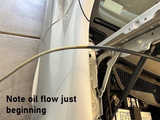

3. Place the dip stick length PVC plastic tube down the dip stick home with 3-6 inches exposed above the entry point. Now connect it to the larger PVC tube attached to the extractor. The high point should be 3-6 inches above the dipstick mouth and remaining of the tub going downward toward the extractor. Try not to have any other curls, up/downs or another high point before the extractor connection.. The shortest path will make your life easier.
4. Select extract on the extractor and pump the handle 10 times to begin oil extraction. Some have said pump until you fill resistance and you see oil flowing. It's kind of a feel thing. The manual warns against over pressurizing the pump to avoid failure but, I may have pumped 15 times.
5. Now be patient, oil should begin to flow and it will take some time. Refer to my time table below
My time table:
2:43 mins- oil was at the first line.. Or 2 liter mark
8:43 mins- Oil was at the send line or 4 liter mark.
15:58mins- Oil was just below the third line.

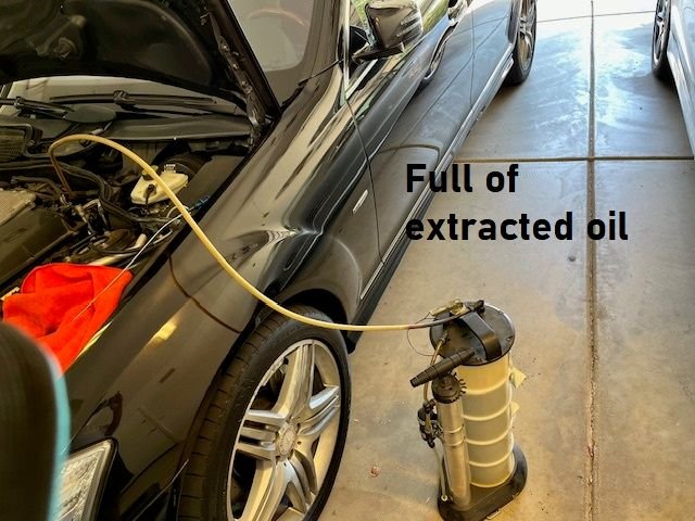

19:50 mins- Oil was at the third line. I was concerned and unsure how much more oil was available to extract. Knowing I was already down a quart from my pre-inspection, I know there had to be another quarter available to extract.
24min-- Not much movement.Still unsure but, I started checking the line and notice at the connection point of both tubes, oil was just sitting. So I made the decision to release the pressure in the Mityvac, preposition the tub and pressurizer the size.
BOOM, Winner, Winner. Oil began to flow much faster and it was 3/4 of the way to the 4th line . I then began to hear the sound I was waiting for. The gurgling sound. Like someone was sucking thru a straw. with nothing left. The line had bubbles in it within the next 2 or 3 minus and it was slurping up the last of the oil.
28mins- I calculated I had 7.5 -8.0 quarts in my extractor and the line became clear with no oil in it. That's when i called it quits and felt good about my extraction.
6. Replace the filter and the rubber gasket around the filter cap. Put the oil cap back on. (Some people forget this step for some reason)
7. Reinserted the dip stick, then removed the oil cap and began filling. Now I went directly to 7 quarts thinking i knew exactly what was needed. When I checked the dip stick, it showed over filled. Immediate panic set in for 10 seconds, then I realized I should start the car and let it run for 1 min. After starting the car, then shutting it off and rechecking, the level was just below full. I probably can add 1/2 to 1 quart. Lesson learned, add about 5-6 quarts then begin the process of starting and checking oil to ensure you don't relive my panic moment.
8. Excavate the oil into the old containers and jump for joy. Not one drop of oil spilled anywhere and I'm not wearing oil like normal.
My thoughts:
They Mityvac 7201 was awesome with Oil. it was my first use and it drew the oil with little assistance from me.
The inboard container is large enough to handle a single oil change without stopping and dumping the oil before continuing.
The pump was responsive and immediate in creating suction within the first 5-6 pumps.
The excavation was life saving. I never touched any oil while distributing the old oil back into the original containers.
The device is durable and felt solid. At no time did I feel it was going to tip over or leak.

I just completed oil changes on M273 in SL550 and M278 In Sclass both with dipsticks, using the above procedure, thank you for a great write-up.I extracted 8 quarts in each.
Some people asked for pictures, with this post I will add a few. I had to modify one of the adapters which was meant to be more of a connector of 2 different sized extracttion hoses, by drilling/reaming the small hole to a larger size to match the extraction hose. the tapered end fits perfectly where the dipstick was, creates a perfect seal.
