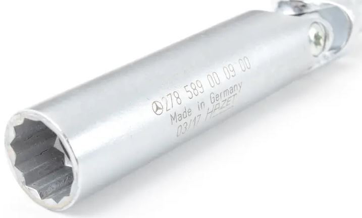

[QUOTE[/QUOTE]i was told the spark plug socket is a 12 point and if so does anyone know what size ? Any info will be appreciated .

14mm spark plug socket that has the swivel and extension permanently connected matching MB tool.

Thank you for the info I purchased that socket from Mercedes benz today
