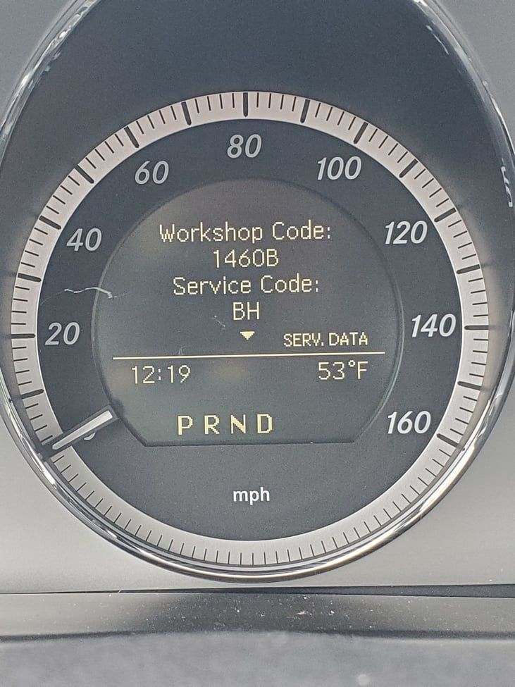

Go into the ASSYST PLUS menu on the dash and it should list which services are needed.
My W204 recently showed that service BH was due which I had no idea what it meant. go into ASSYST PLUS and scroll thru until it lists the service 1-20. I have read this list is the same for all Mercedes models. I dont know how to get into your specific menu but ill post how I got in mine. The services listed for mine 2,3, 11, 13 made perfect sense and lined up with the services listed in the Maintenance Manual since my car just turned 150,000 miles and was due for a new fuel filter and replace the coolant.
